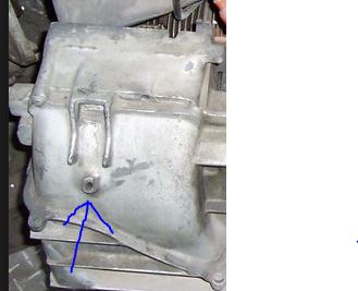

jsaum   OK I got this picture on Google for a VW type 4 so...   Jun 24 2014, 04:42 PM
jsaum   OK I got this picture on Google for a VW type 4 s...   Jun 24 2014, 04:43 PM
Dave_Darling   With the extra holes on that, I'm betting that...   Jun 24 2014, 05:08 PM
Cap'n Krusty   With the extra holes on that, I'm betting tha...   Jun 24 2014, 06:14 PM
zambezi   Yup, stock bracket. You can just barely make out ...   Jun 24 2014, 08:39 PM
jsaum   OK I think I figured it out probably the bracket w...   Jun 27 2014, 02:12 PM
Cap'n Krusty   Way to go. I would put a nut and washer between t...   Jun 27 2014, 03:30 PM
jsaum   Yes I did put a nut there so it shouldn't back...   Jun 28 2014, 10:31 AM
