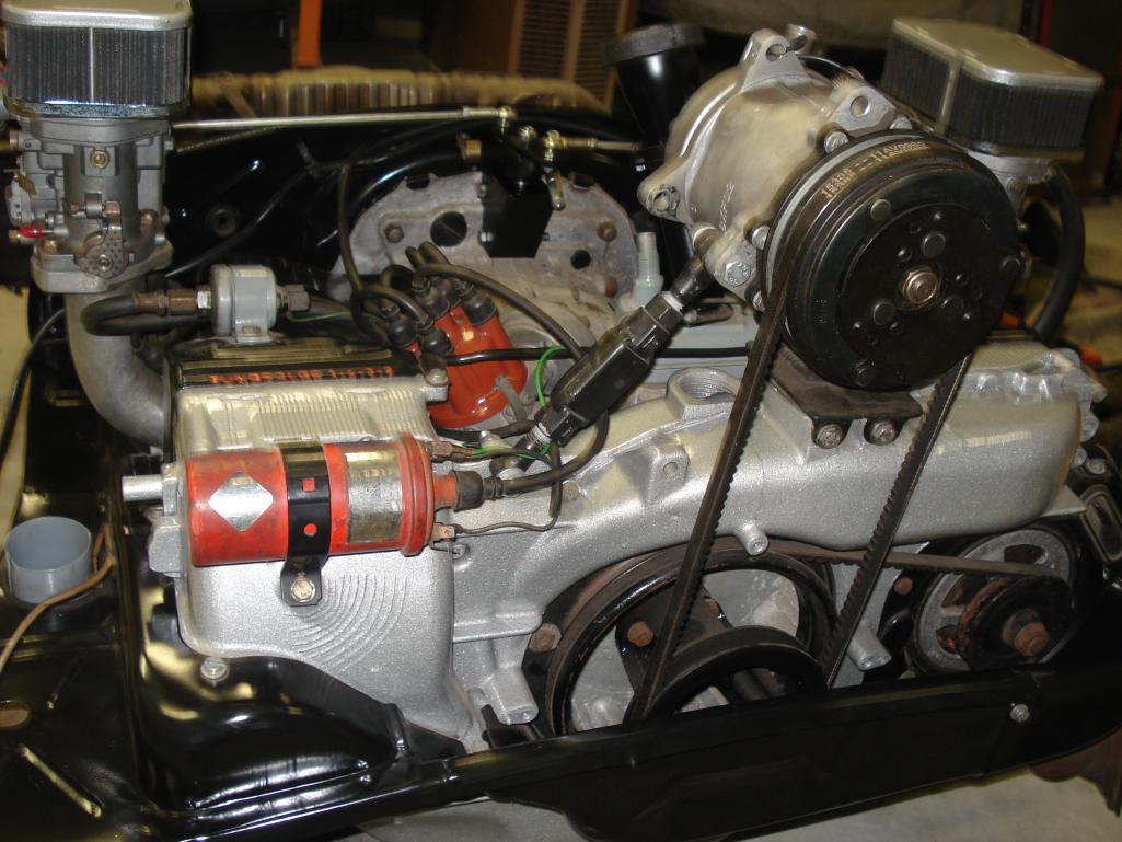

I'm in the middle of an engine swap and am so close to getting my car on the road I can barely stand it! I'm putting a 1.8 motor from a 75 into my 72 and found that the size of the coil that normally mounts to the engine tin is different from the one that has the bracket that mounts on the blower housing. Does anyone know the correct part number or coil to use for that mounting bracket?

Yup, stock bracket. You can just barely make out the raised square section of the factory bracket.

Dave_Darling   Look up on the engine tin. You'll find two ho...   Jun 23 2014, 04:34 PM

Cap'n Krusty   Might want to give us a picture of the coil and th...   Jun 24 2014, 10:35 AM
sean_v8_914   i do not recommend "on the tins" mountin...   Jun 24 2014, 12:15 PM

jsaum   OK I got this picture on Google for a VW type 4 so...   Jun 24 2014, 04:42 PM
jsaum   OK I got this picture on Google for a VW type 4 s...   Jun 24 2014, 04:43 PM
Dave_Darling   With the extra holes on that, I'm betting that...   Jun 24 2014, 05:08 PM
Cap'n Krusty   With the extra holes on that, I'm betting tha...   Jun 24 2014, 06:14 PM
zambezi   Yup, stock bracket. You can just barely make out ...   Jun 24 2014, 08:39 PM
jsaum   OK I think I figured it out probably the bracket w...   Jun 27 2014, 02:12 PM
Cap'n Krusty   Way to go. I would put a nut and washer between t...   Jun 27 2014, 03:30 PM
jsaum   Yes I did put a nut there so it shouldn't back...   Jun 28 2014, 10:31 AM
