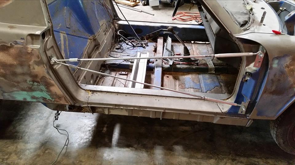

Fabricated the braces to keep everything straight and correct while on the rotisserie! Thinking of making several sets of these if anyone is interested! I wasn't gonna pay what some of the vendors were charging for these. They screw right in the existing door latch holes with the custom brackets we made! Very efficient and strong, also adjustable!

Sfreeman615   Fabricated the braces to keep everything straight ...   Jun 26 2014, 09:01 PM
zambezi   Looks good, the only problem I have with braces in...   Jun 26 2014, 11:49 PM
Sfreeman615   Looks good, the only problem I have with braces i...   Jun 27 2014, 09:16 AM
malcolm2   Looks good, the only problem I have with braces i...   Jun 27 2014, 10:04 AM
