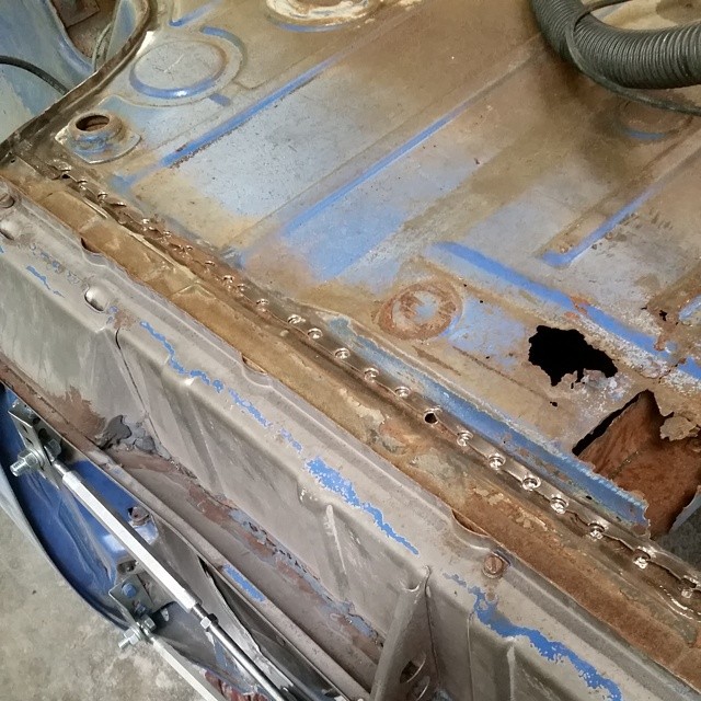

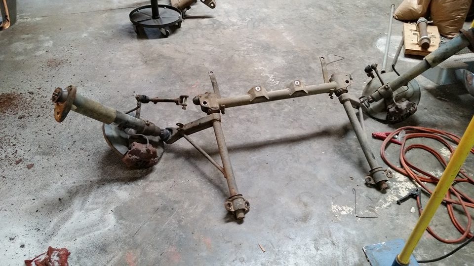

More work being done today! Finally got to see my teener upside down! LOL. All of the suspension is out. Taking lots of pieces to powder coating next week. Also got some spot welds drilled out!

Sfreeman615   UPDATE: Thanks to a great heat gun I finally got t...   Mar 29 2014, 10:01 AM

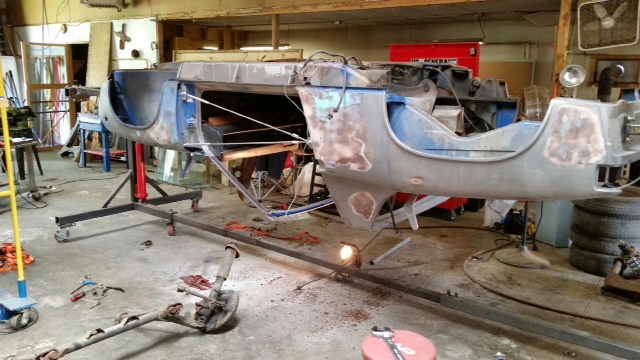

Sfreeman615   Getting ready for the rotisserie! Replacing fl...   Jun 24 2014, 07:13 PM
malcolm2   Hey, good to see some pictures. I just asked Mike...   Jun 24 2014, 07:24 PM
Sfreeman615   Hey, good to see some pictures. I just asked Mik...   Jun 24 2014, 07:58 PM
Sfreeman615   Fabricated the braces to keep everything straight ...   Jun 26 2014, 09:01 PM
zambezi   Looks good, the only problem I have with braces in...   Jun 26 2014, 11:49 PM
Sfreeman615   Looks good, the only problem I have with braces i...   Jun 27 2014, 09:16 AM
malcolm2   Looks good, the only problem I have with braces i...   Jun 27 2014, 10:04 AM

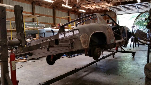

Sfreeman615   More work being done today! Finally got to see...   Jun 27 2014, 05:50 PM
trojanhorsepower   Man you are smoking along! Great work. Are y...   Jun 27 2014, 05:58 PM
Sfreeman615   Man you are smoking along! Great work. Are ...   Jun 27 2014, 06:11 PM

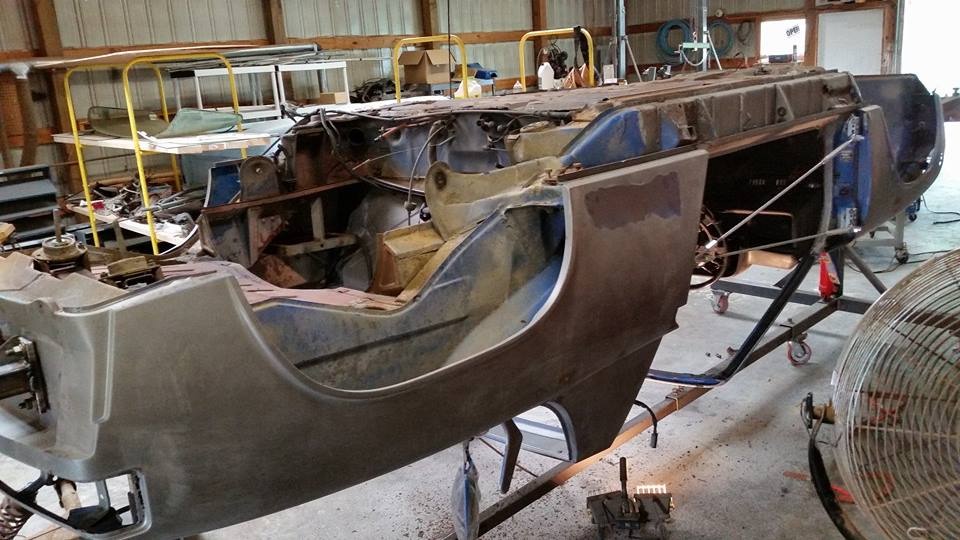

Sfreeman615   More progress in the last few days! Over the n...   Jul 9 2014, 06:06 PM
Mblizzard   That's a big hole! Keep welding :welder:   Jul 9 2014, 06:12 PM
