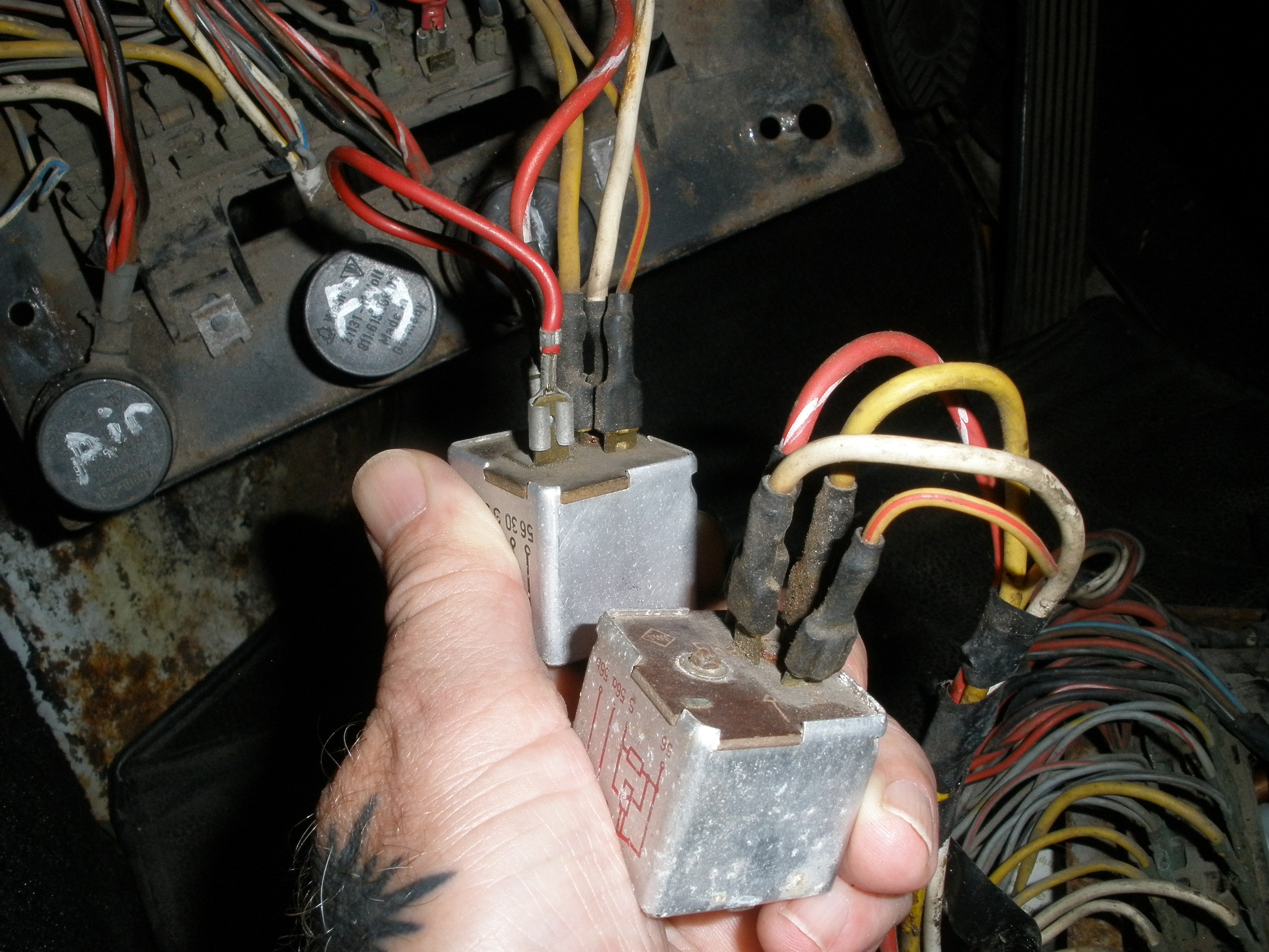

Today I thought I would pull the headlight dimmer switch and do a swap with another one I had and lo and behold I see my spare is quite different than what I have on my car. The one on my car has a "jumber" so I'm thinking the PO used a different dimmer and that this "jumper" is part of doing that. Notice in the image my spare has no jumper and the different number of tang contact points between the two.
Anyone have any experience with this?
I suspect my spare is the appropriate dimmer.
After this I can only think of one more component I can change before doing continuity checks on the wires and that would be my ignition switch (I do have a spare). Grrrrr.
How bout the difference of those dimmer switchs ya'll?

Yes, your spare is appropriate for the '73. My car is a 73 also and I replaced a bad dimmer relay the same way (by adding the jumper). Just wire it the same way, with the jumper removed.

Thanks DadaDaveed,
One thing that has me slightly confused....
Notice the difference in wire placement in comparrison?
My spare has the white wire at 56 and the yellow wire at 56a, but the one on the car (that's jumped) has the yellow wire at 56 and the white wire at 56a. Any thoughts about this?

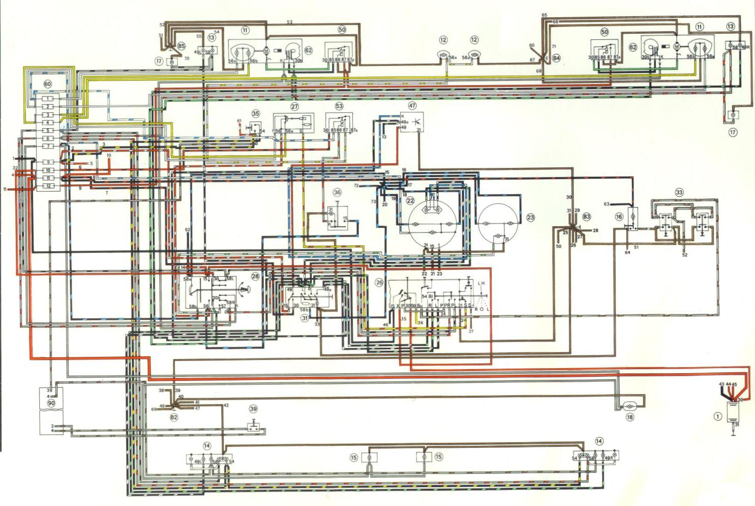

Here's a better image and the schematic (Believe it's component 27 combination relay, right?):
