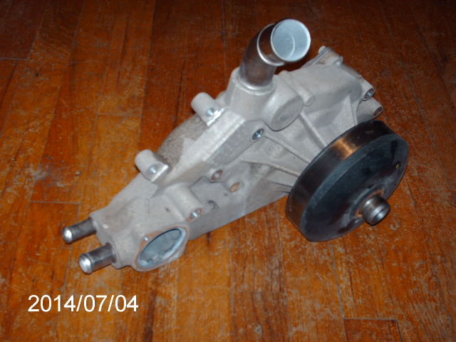

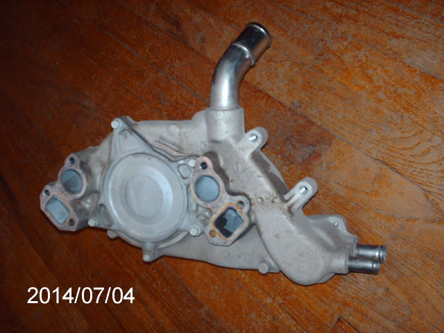

Some of the stuff I can probably use from the Subie conversion, and some things I was able to look up, but some I'm not able to put the face to it.
Adapter and clutch @ 1000$ from KEP Engine bar- 200$ from the kit guys Transaxle relocating offsets- 20$ worth of metal, drilled. Toy-Jet water manifold (replace the water pump)- 250$ Hose transitions - 30$ from Jags that run. High torque starter- 200$ Ebay |

Some of the stuff I can probably use from the Subie conversion, and some things I was able to look up, but some I'm not able to put the face to it. Adapter and clutch @ 1000$ from KEP Engine bar- 200$ from the kit guys Transaxle relocating offsets- 20$ worth of metal, drilled. Toy-Jet water manifold (replace the water pump)- 250$ Hose transitions - 30$ from Jags that run. High torque starter- 200$ Ebay The Kennedy adapter for the Boxster transaxle alone is $1900. This is without the clutch Kit. You can use a stock Porsche one at $650 or the Kennedy one at $950. You can get all of the water pump fittings from Meziere and the remote pump. This will be almost $1000. Stuff adds up fast. Makes keeping the Subaru engine look better. If I was you I'd spend about $1000 and just put a Subaru transaxle in your car. It will feel like a different car with this. Bob |

Some of the stuff I can probably use from the Subie conversion, and some things I was able to look up, but some I'm not able to put the face to it. Adapter and clutch @ 1000$ from KEP Engine bar- 200$ from the kit guys Transaxle relocating offsets- 20$ worth of metal, drilled. Toy-Jet water manifold (replace the water pump)- 250$ Hose transitions - 30$ from Jags that run. High torque starter- 200$ Ebay The Kennedy adapter for the Boxster transaxle alone is $1900. This is without the clutch Kit. You can use a stock Porsche one at $650 or the Kennedy one at $950. You can get all of the water pump fittings from Meziere and the remote pump. This will be almost $1000. Stuff adds up fast. Makes keeping the Subaru engine look better. If I was you I'd spend about $1000 and just put a Subaru transaxle in your car. It will feel like a different car with this. Bob Wow that LS adapter for the boxster is $$$ wonder why so much more than the Ls/901 adapter? I went with the Dedenbear water pump- WP3 @314$ but you can catch discounts that bring them down @ 280$. Autoplicity.com Look for Mezieres on Craigslist, the boating community uses them. The log plenum from Toyjet I see is up to 350$ (IMG:http://www.914world.com/bbs2/uploads_offsite/i60.photobucket.com-3782-1397968657.1.jpg) Jags that run.com hose adapters- (IMG:http://www.914world.com/bbs2/uploads_offsite/jagsthatrun.com-13632-1400240537.1.jpg) Renegade will sell you the engine bar- (IMG:http://www.914world.com/bbs2/uploads/post-3419-1314666698.jpg) Here is a list of conversions. Look for build threads by member name. http://www.914world.com/bbs2/index.php?sho...c=20374&hl= |
