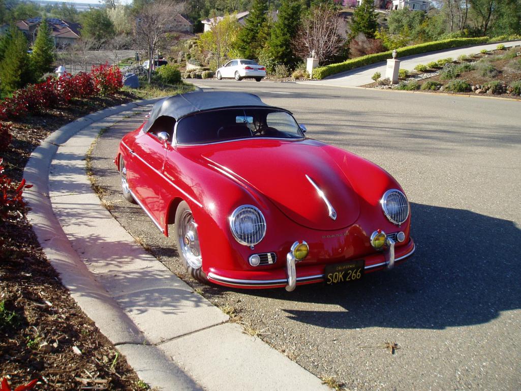

I became one of THOSE people this weekend who has acquired a '75 Malaga Red 2.0L that's been in a garage for 20+ years! Cookie cutters with a 911 front end. From the looks of things, somebody may have been involved with local racing. It wouldn't be a 914 without a little rust under the battery, but that appears to be very limited as everything under the rockers it solid.

speedster replica???
pics? Price?

I sent you a PM with the details. This is the old car.
