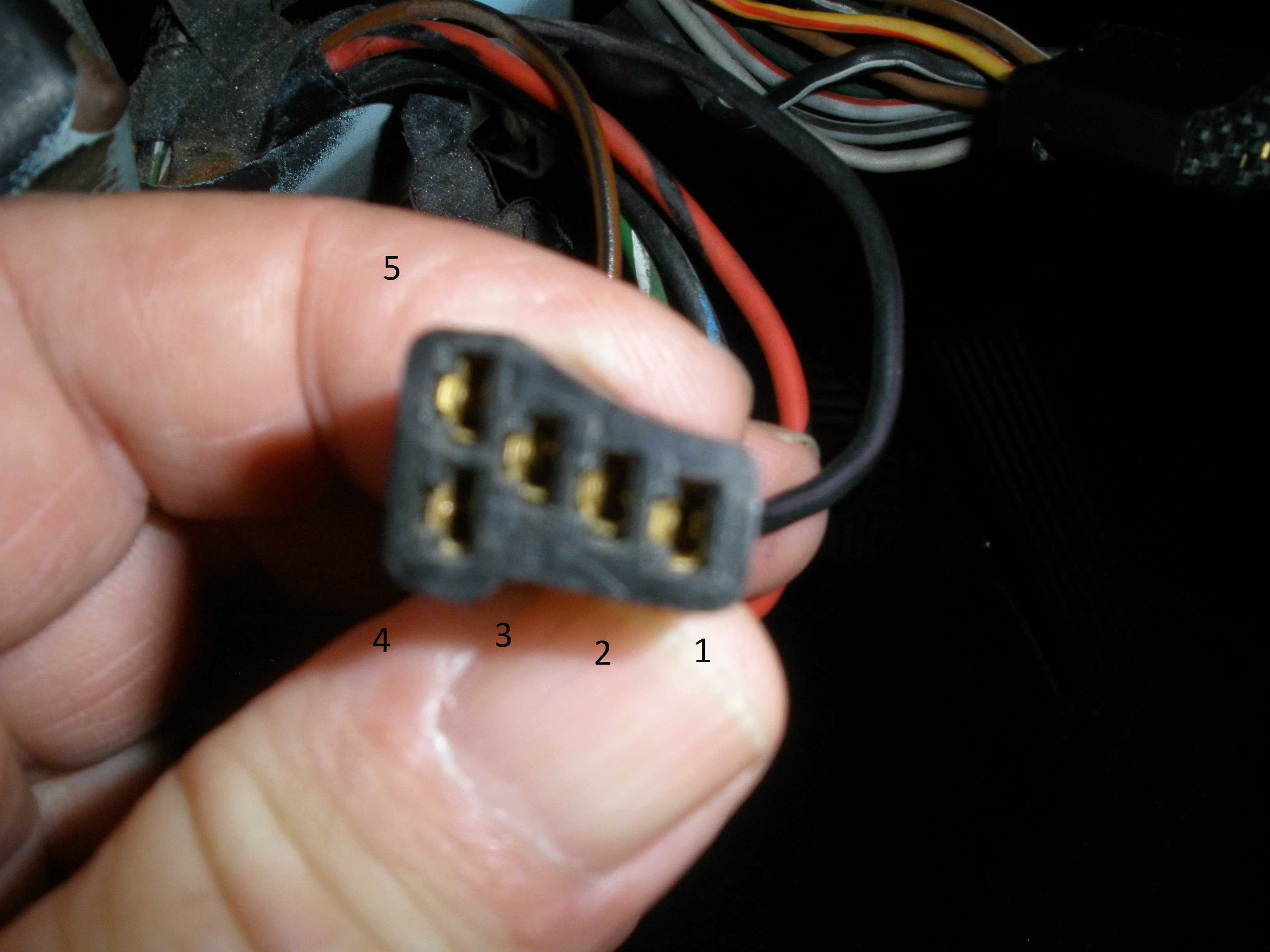

Found something interesting. A continuity problem (and let's be clear, testing for continuity is very different than testing for power).
The wire/s from 53a should have continuity at the steering wheel column connector slot 2 and 4 (see picture). Continuity exists in the wire from 53a to slot 2 but not at slot 4. (crap-see below. I goofed where slot 4 and 5 are located). No continuity 53a second wire to slot 5 of the connector)
I wonder if I've found the problem?
Here's the rest of the continuity test result (and remember, continuity and power detection are very different tests)
(slot 5) 53=yes
(Slot 2 and 4) 53a=slot 2 yes, slot 4 fail!
(Slot 1) 53b=yes
(Slot 3) 31b=yes
Tested with battery disconnected, all wires at wiper disconnected and wiper switch at the column disconnected
Addedum-Oh crap. I screwed the pooch. The numerication of the slots is wrong. 5 should be 4 and 4 should be 5.
So the revised results would be
(slot 4) 53=yes
(Slot 2 and 5) 53a=slot 2 yes, slot 5 fail!
(Slot 1) 53b=yes
(Slot 3) 31b=yes
