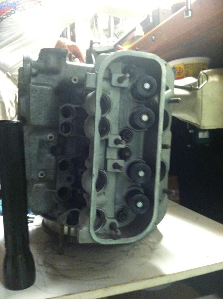

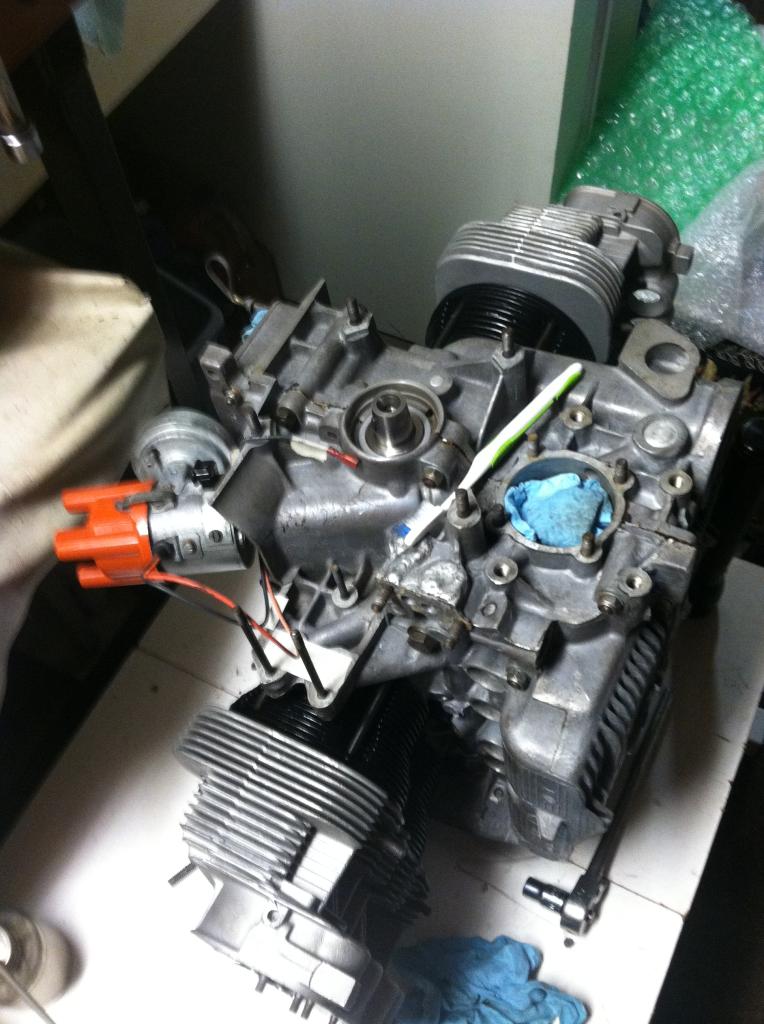

(IMG:http://www.914world.com/bbs2/uploads_offsite/i821.photobucket.com-16526-1406439812.1.jpg)
(IMG:http://www.914world.com/bbs2/uploads_offsite/i821.photobucket.com-16526-1406439812.2.jpg)
Got the heads on, Shimming the endplay is becoming a pain in the arse though.
I am going to need some serious help when it comes to putting the tin all together.
and doing the t stat.
Little by little im getting there.
