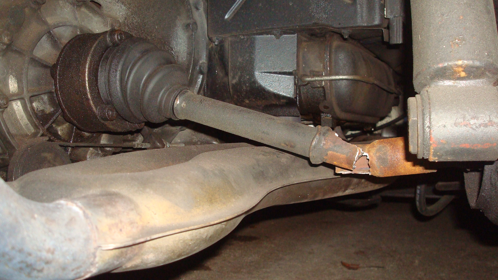

So I was running up to the store to drop off some Red Box movies, and pulling away from a stop sign I heard a loud pop....then the car stopped moving. The engine was still running and idling fine, but when I put it into 1st again and tried to pull away, the car didn't move and I could hear a sound like rocks in a rock tumbler. I'm guessing clutch pieces rattling around the bell housing?
I tried just shifting through the gears while stopped and I could find every gear fine, so I'm hoping it's nothing internal to the trans.
Luckily this happened just a few hundred yards from my house in my neighborhood so getting it back to my house was easy. I'm going to have it towed to a local aircooled shop. But does this sound like a clutch disc that shattered, or possibly something more serious?
Of course this had to happen just after I sold my Karmann Ghia, so I have no other means of transport except to borrow my girlfriend's car!
era vulgaris
post Jul 29 2014, 05:48 PM
J is for Genius
Posts: 986
Joined: 10-November 13
From: Raleigh, NC
Member No.: 16,629

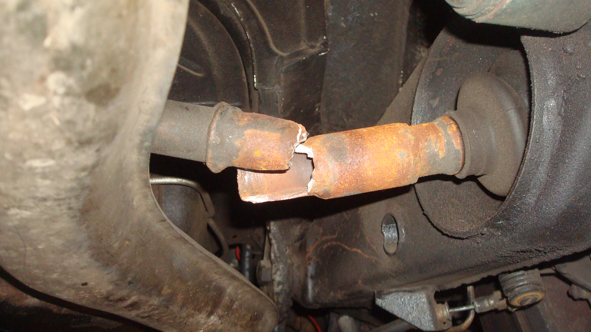

Well, the CV joints might still be an issue...but sometimes the solution is staring you right in the face and you don't see it! Apparently I was too busy looking at the shift linkage and clutch cable, and somehow missed THIS!!! Only the passenger side axle snapped. Driver's side is still in one piece.
According to Scotty Boy, these were 930 CV's and 911 axles. Anyone care to confirm or deny that?
Also, anyone know a good source for new axles and CV's?

Krieger   That is a custom POS axle. It looks like it was c...   Jul 30 2014, 02:28 PM
Andyrew   That is a custom POS axle. It looks like it was ...   Jul 30 2014, 03:13 PM
Old Yella   Just get two new complete axles with cv's and ...   Jul 30 2014, 02:28 PM
Racer Chris   The person who thought it was a good idea to weld ...   Jul 30 2014, 03:34 PM
