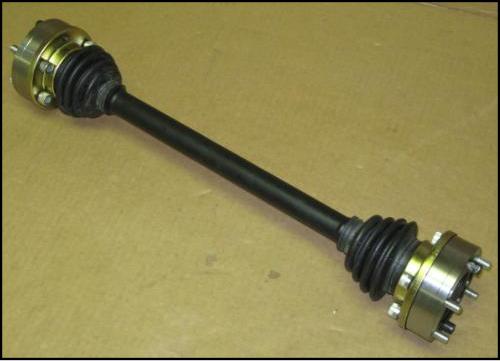

Eric_Shea   Just buy a pair of free floating Sway-A-Way axles....   Jul 31 2014, 08:46 PM
era vulgaris   Just buy a pair of free floating Sway-A-Way axles...   Jul 31 2014, 08:56 PM

Mike Bellis   These are chrome moly and cheaper... This is what ...   Jul 31 2014, 09:33 PM
