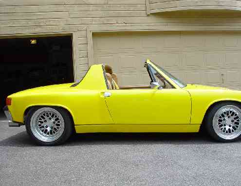

Well it has been a wierd wild ride so far with my project. I left my car in TJ for the flares on a Sunday. By the time I got home I had a call asking me to come back down the following Monday to make sure the vision their welder had and the vision that I had were the same......they were not. The welder cut my rear fender about two inches around the wheel well and put a straight four inch piece of metal coming out perpendicular with the 2' piece attached on to that. It looked like a shelf around my wheel....really F-ing ugly. I didnt freak, though. I just remembered that I know where to get a free set of good fenders to fix this mistake. I brought them a picture of my wants and then explained how to do it. They asked me to come back the next day to inspect. I was nervous, but when I returned I found what I wanted. It cost me $990 ($90 was tax) for the flares, and for them to weld in my engine mount for the six. It prolly would have been cheaper if some dirty tail dragger with cash haddent given them the idea that we "all" have money (James)(IMG:style_emoticons/default/wink.gif) The price was still good though. The only thing that needs to be attended to now is evening up the contours. I will be buying a contour gauge to show them how to allign everything> this will not cost anything extra...just time.

Here's another fabricated steel reaer flare
Andy

jgiroux67   So did you take off your 1/4 panels and replace th...   Aug 16 2004, 09:35 PM
Dr Evil   Nope, it turns out that the best way I could see t...   Aug 16 2004, 09:37 PM
Lou W   Looks Great!! Do you have any pictures sho...   Aug 16 2004, 09:57 PM
red914   that is a sweet understated look. nicely envision...   Aug 16 2004, 10:20 PM
Dr Evil   Lou, all of the work was done in Mexico. I just h...   Aug 16 2004, 10:22 PM
Lou W   I definitley like the almost stock look to the fla...   Aug 16 2004, 10:31 PM
Dr Evil   Just like this. I love this look :drooley: Same wh...   Aug 16 2004, 10:35 PM
Lou W   That looks great. You're heading in the right ...   Aug 16 2004, 10:48 PM

andys   Was the process something like this? Andy   Aug 17 2004, 10:04 AM
andys   Hmmm, file problem. Try this one:   Aug 17 2004, 10:20 AM
nynone4   Excellent!! This is the sort of flare I...   Aug 17 2004, 10:41 AM
John Kelly   DR Evil, You got a great deal on your flares, and ...   Aug 17 2004, 11:08 AM
flyloki   Great pics on that site.... How do you do the fina...   Aug 17 2004, 12:14 PM
Dr Evil   There is only a small amount of filler if any just...   Aug 17 2004, 12:32 PM
Dr Evil   Oh ya, no doubt that John Kelly is THE MAN! I ...   Aug 17 2004, 12:37 PM
