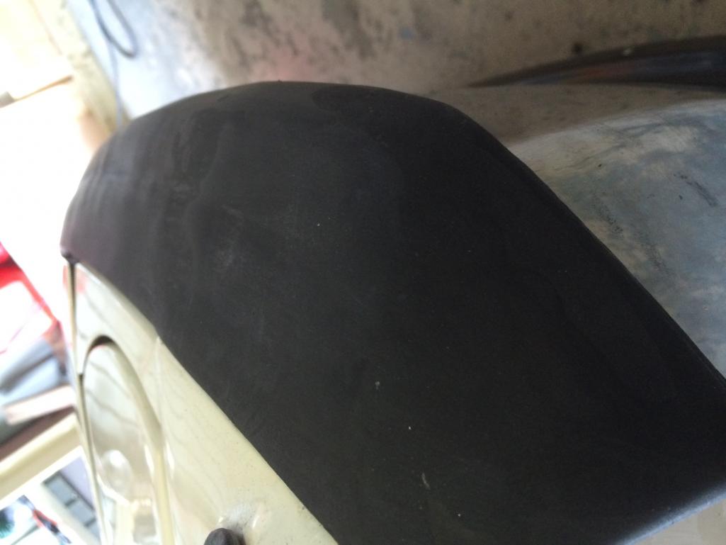

My front bumper top pad is pretty much a loss so thought I would try an idea for a fix that was floating around in my head. I have used this stuff on my boat and thought it had possibilities. It is super sticky adhesive, comes in black, and available at home depot maybe. If not I got this from Grainger.

Another "done" pix. Not sure how it will wear but this stuff is unaffected by years of exposure on boats. Wonder how it will look after application of some of the popular rubber preservatives like Armorall??

76-914 Cool. I hope this works and that it ISN'T like... Aug 7 2014, 07:26 PM
saigon71 Looks good! :beer2: Aug 7 2014, 07:39 PM
Porschef 5200 takes a week to cure fully, no problem there.... Aug 7 2014, 08:10 PM
gereed75
5200 takes a week to cure fully, no problem there... Aug 7 2014, 08:24 PM
euro911 Awesome. There's a little chunk out of my rear... Aug 7 2014, 08:25 PM
Krieger That looks great. If you had a mold you could mak... Aug 7 2014, 08:26 PM
