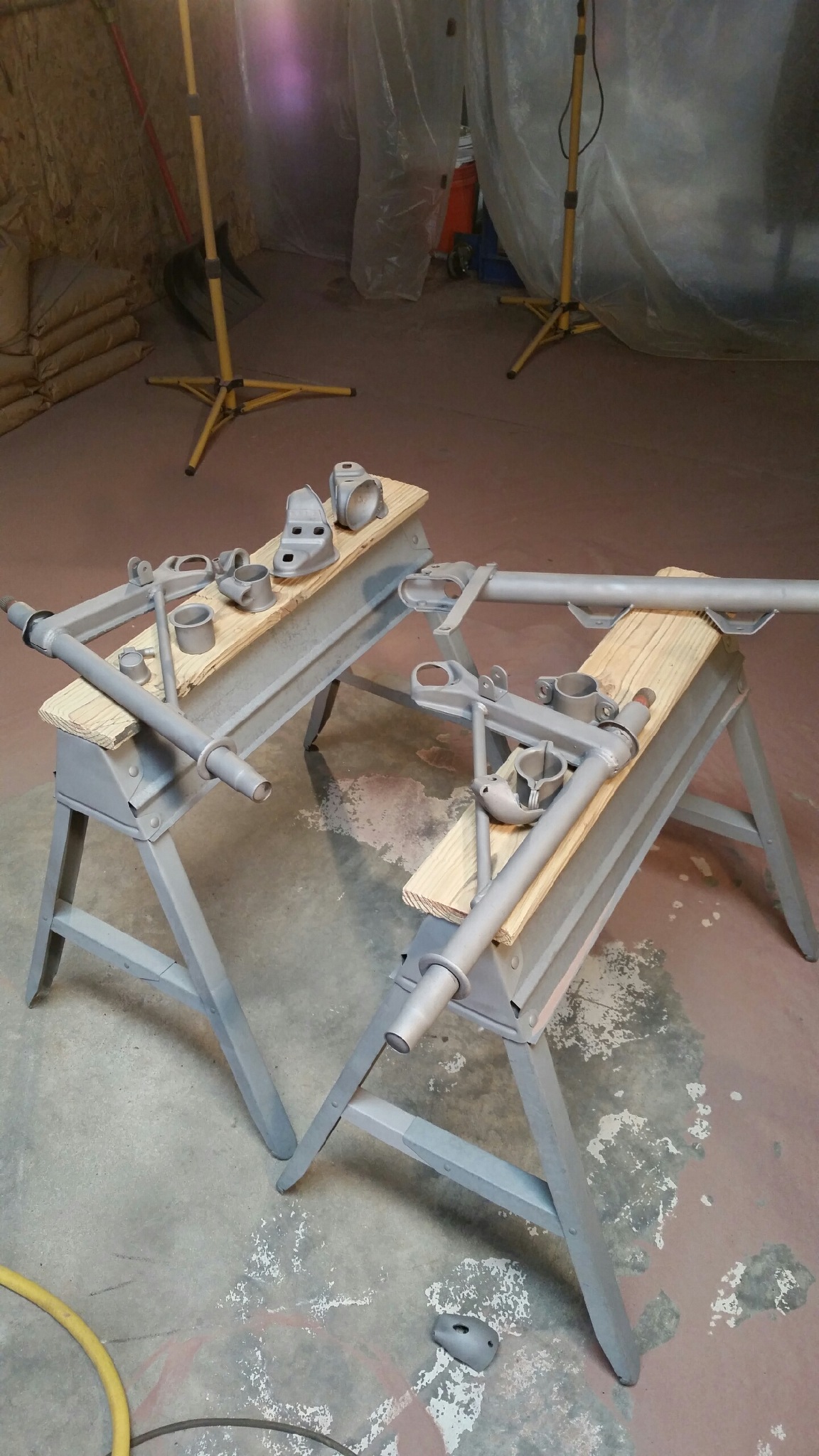

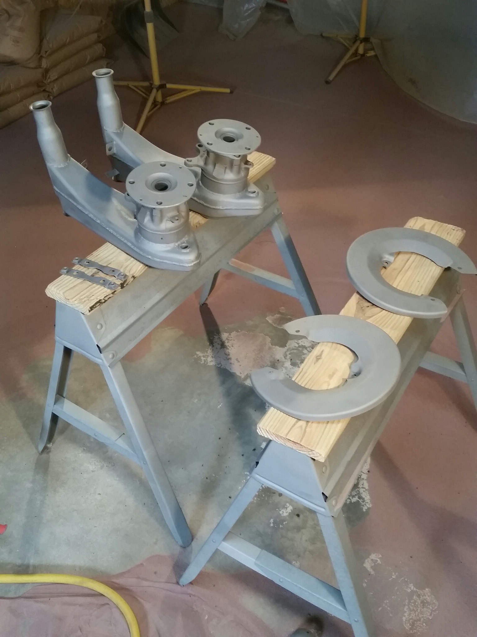

Starting to come together now! Getting exciting that's for sure. Today we blasted the front and rear suspension components and got them ready for paint.
