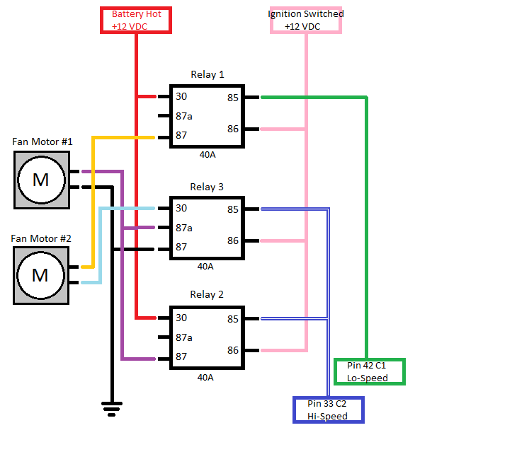

For my Suby 6 conversion I've installed a twin fan system (from a Dodge) on my radiator. One is single speed (3 wire) and the other is 2 speed (4 wire). Which one of these 2 fans comes on first? Do they both run at times? Will I use the 2nd speed of the 2 speed motor?

Gotta bump this great thread...Just a quick question...
Just ordered my 5 pin relays (the SVX stock ones are 4 pin), just trying to understand this diagram. I decided not to use the SVX fans since they are huge and when I started my car and let it run for 10 minutes and it didn't even come up to temp so I'm thinking that's overkill.
My new fans only have two wires (stock ones had 4). Assuming one is power and one is ground. On the diagram it's showing that I only ground ONE of the fans directly and then ground relay 3, which the second fan is connected to. Is that correct?
reposting the diagram:

76-914   Help :blink: I'm trying to figure this schema...   Dec 8 2013, 08:41 PM
Mike Bellis   Help :blink: I'm trying to figure this schem...   Dec 8 2013, 09:22 PM
Tom   Kent, It looks like both pins 33 and 42 would n...   Dec 9 2013, 02:16 AM

76-914   Mike & Tom, Thanks for explaining things to me...   Dec 9 2013, 07:27 PM
BIGKAT_83   Mike & Tom, Thanks for explaining things to m...   Dec 9 2013, 07:34 PM
76-914   Spoke too soon. I see relay 2 powering Fan #1 @ hi...   Dec 9 2013, 07:44 PM

76-914   Got my fans & relays wired in tonite :Qarl: I...   Dec 12 2013, 10:12 PM
Chris H.   Gotta bump this great thread...Just a quick questi...   Aug 25 2014, 11:22 AM
76-914   Es verdad, Christo. Looks funny but think of stack...   Aug 25 2014, 05:20 PM
Chris H.   Cool thanks Kent! Just seemed weird not groun...   Aug 25 2014, 05:22 PM
