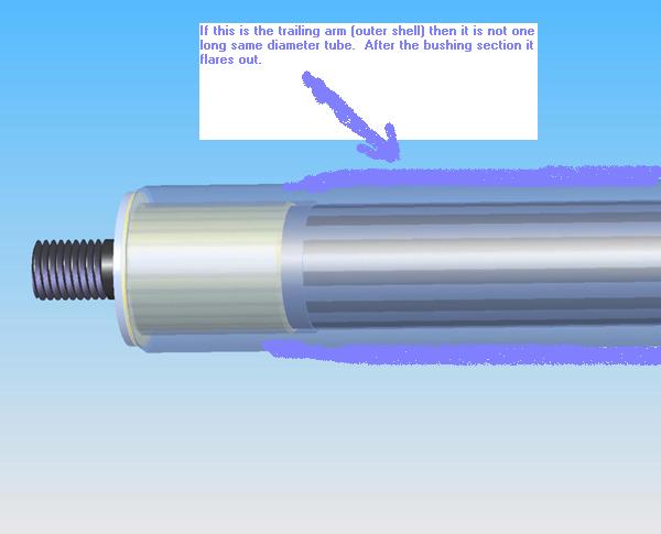

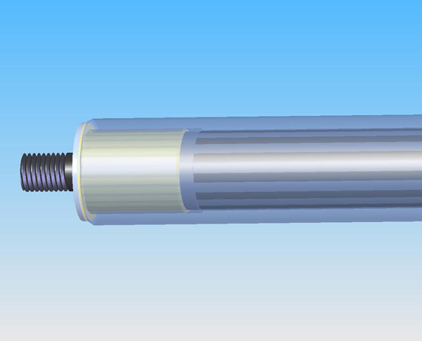

MikeM   I'm pretty sure they have the wrong image ther...   Aug 30 2014, 10:26 AM
lonewolfe   These bushings fit around the trailing arm shaft a...   Aug 30 2014, 02:20 PM
