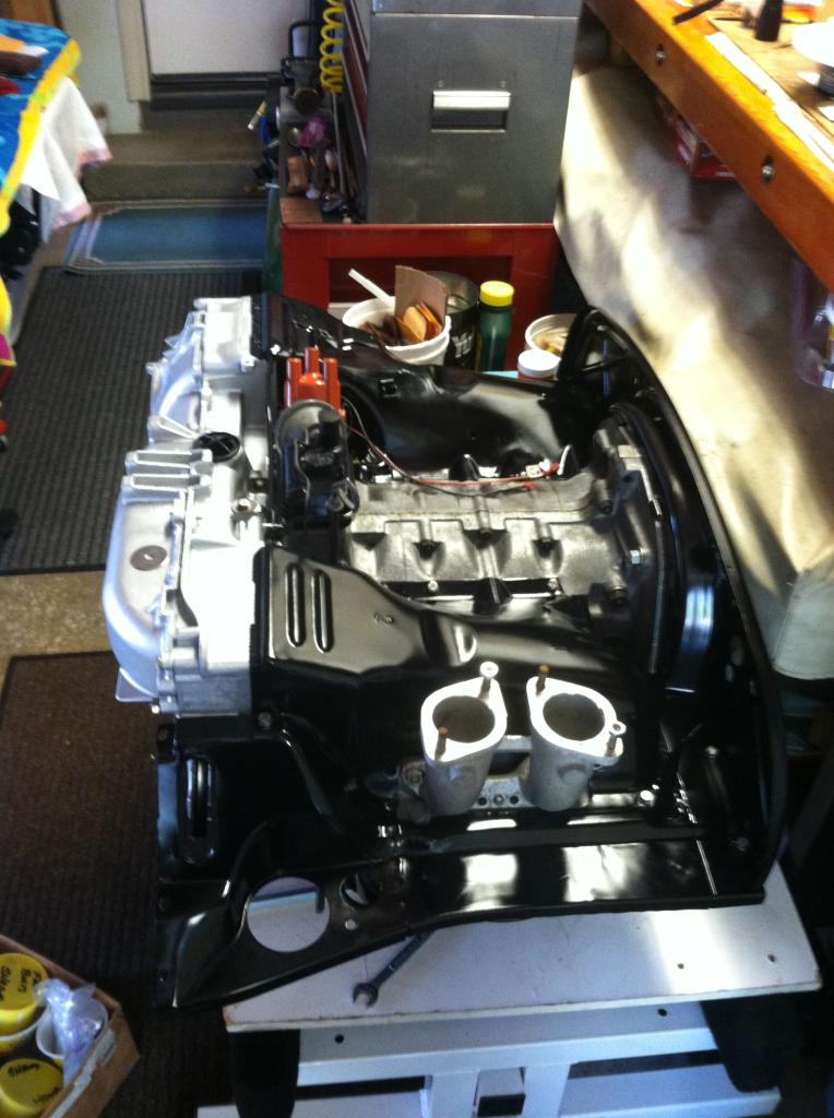

So some updates, Motor is nearly done and ready to go into the car.
Having trouble finding some odds and ends like intake gasket and clutch pressure plate bolts. If anyone knows where to find this stuff let me know. I cant find it anywhere. Im also having trouble with the nuts to fasten the exhaust manifolds. i ordered some from bmw but they are too small.
Also need to find the pins that hold the cable to the caliper for the parking brake and re attach that and change my bum parking brake cable.

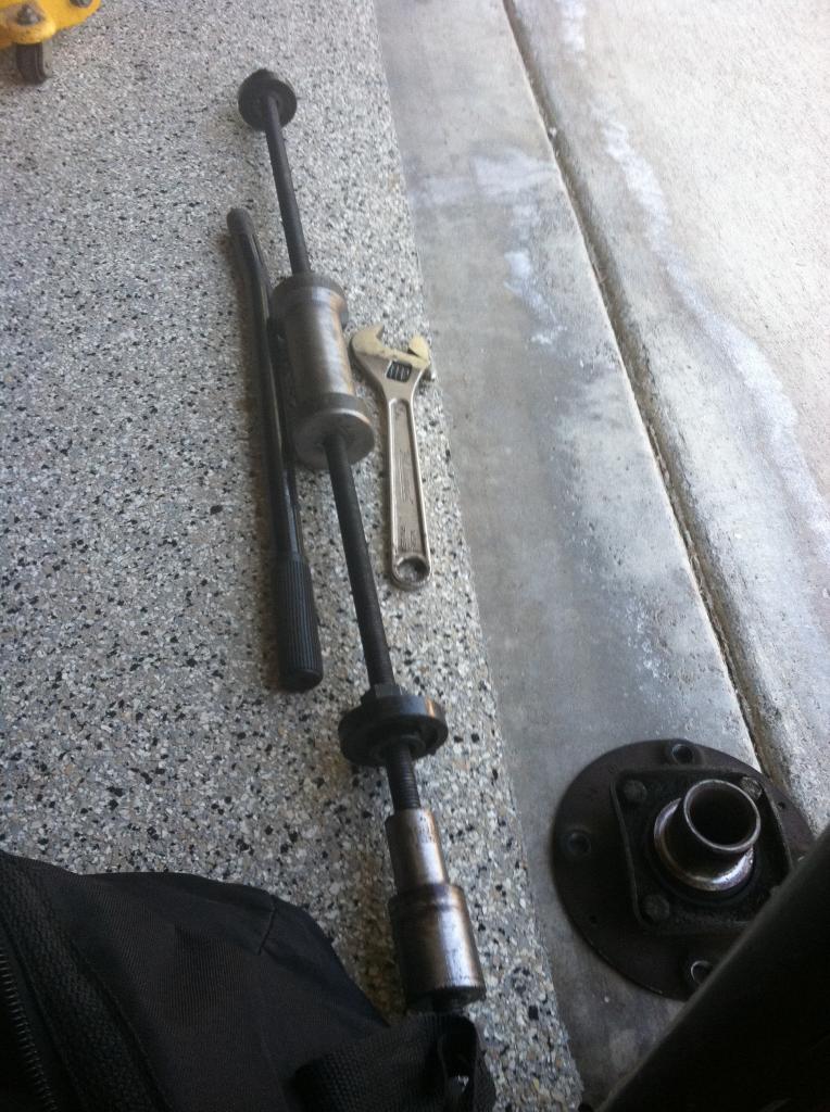

but i also had to address my failed rear wheel bearing so i did that today with some tools that had to be borrowed ( Thank you so much B Stone) however once the tools were correctly applied it was no sweat at all.
I am inherently super lazy, why work hard when you can make something else do the work for you.
this theory often also makes sure that you don't damage things.
Since i did not want to pull the trailing arm from the car i really did not want to damage anything.

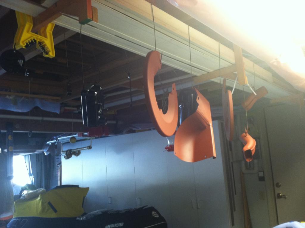

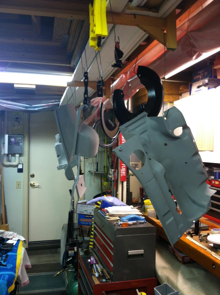

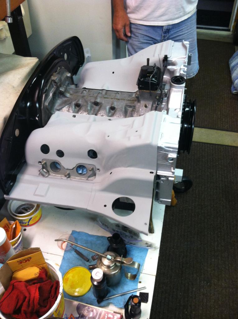

My garage has turned into a paint workshop painting engine tin and random other parts.
Thanks to the baseboard rack i have somewhere to hang all this excess shit.
(IMG:http://www.914world.com/bbs2/uploads_offsite/i821.photobucket.com-16526-1409701459.1.jpg)
(IMG:http://www.914world.com/bbs2/uploads_offsite/i821.photobucket.com-16526-1409701459.2.jpg)
Arthur is always sending me motivation, as he spotted a 914 out on the street in the wild, Proof that they dont only exist on jack stands.
(IMG:http://www.914world.com/bbs2/uploads_offsite/i821.photobucket.com-16526-1409701459.3.jpg)

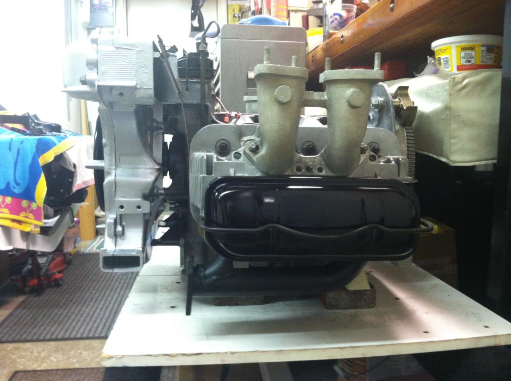

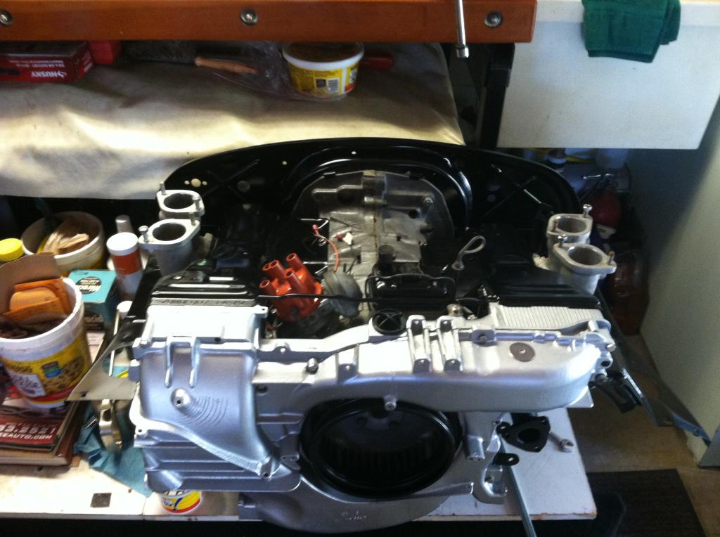

Motor closed up and ready to have the tin put on.
(IMG:http://www.914world.com/bbs2/uploads_offsite/i821.photobucket.com-16526-1409701459.4.jpg)

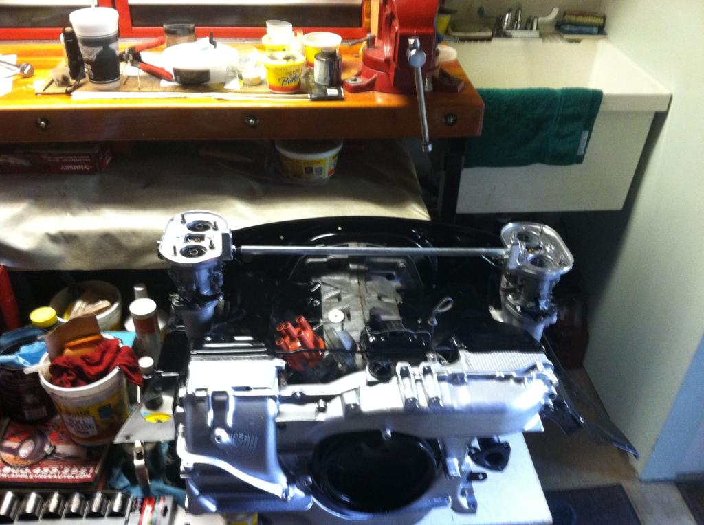

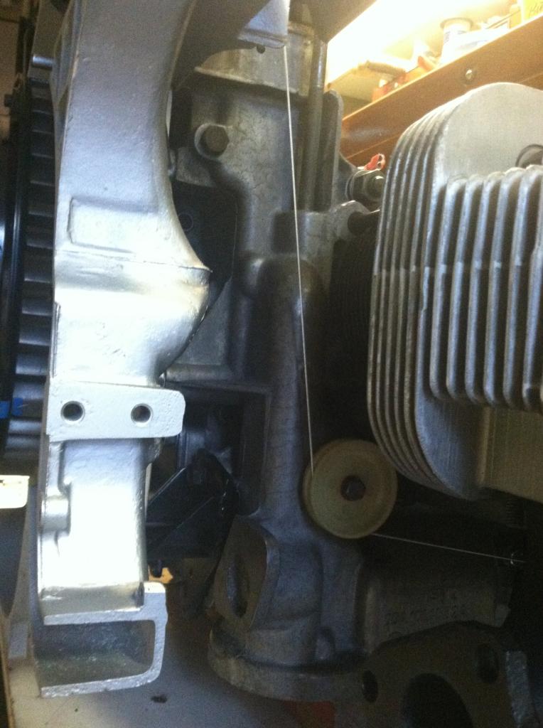

Close up of the thermostat cable and air flaps. Without this the motor wont regulate temp properly. Sucked to buy as it was 134$!
(IMG:http://www.914world.com/bbs2/uploads_offsite/i821.photobucket.com-16526-1409701460.5.jpg)

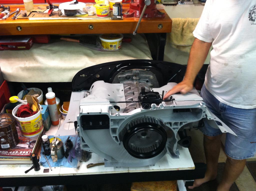

and a shot of how the fan and shroud work to deliver the cooling air to the motor and oil cooler.
(IMG:http://www.914world.com/bbs2/uploads_offsite/i821.photobucket.com-16526-1409701460.6.jpg)
(IMG:http://www.914world.com/bbs2/uploads_offsite/i821.photobucket.com-16526-1409701460.7.jpg)

Special tools, Ill take pictures of me doing the next one i guess.
