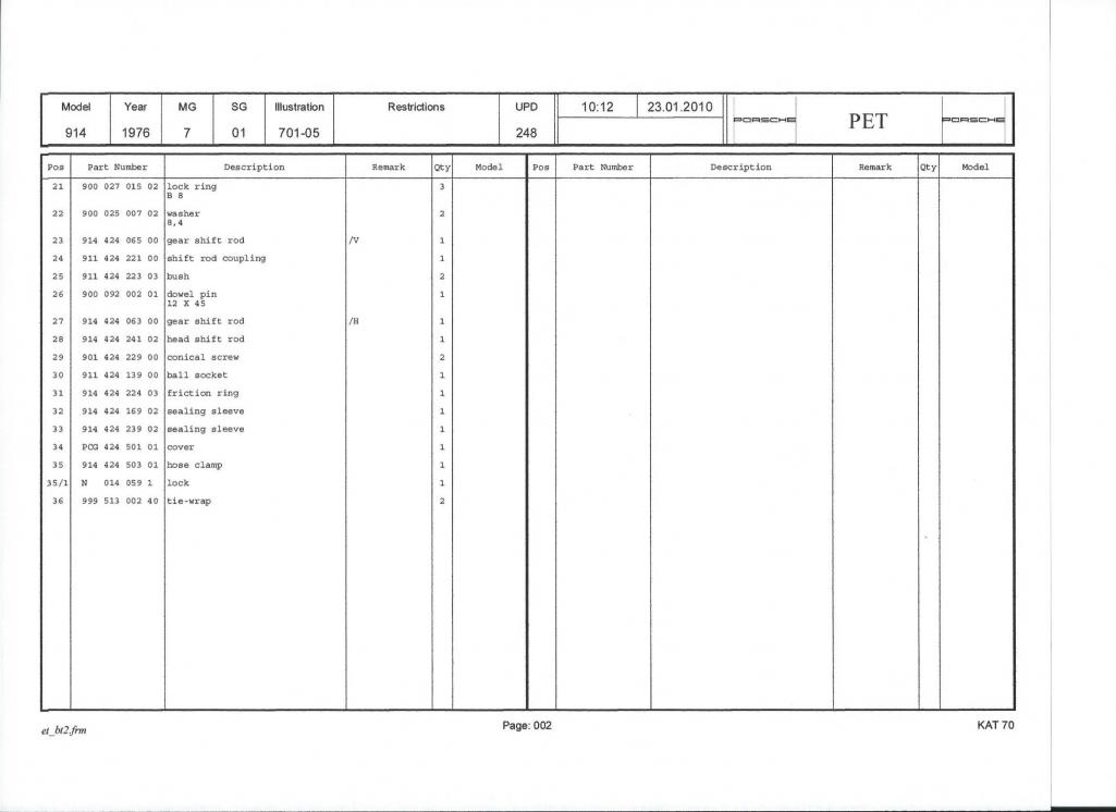

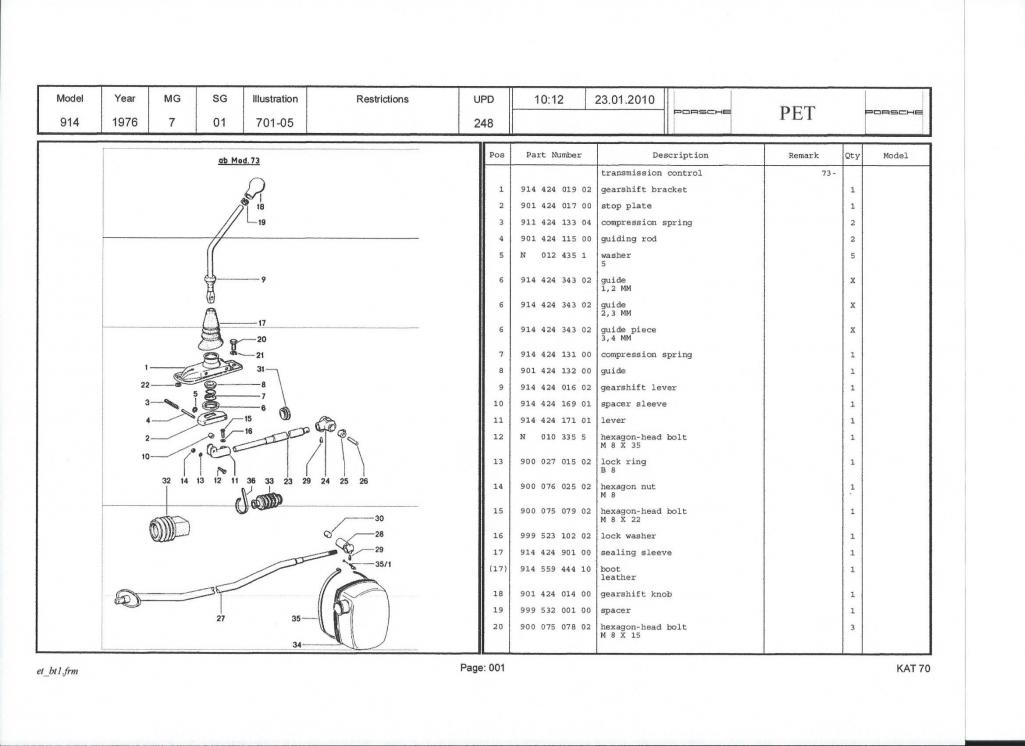

At the base of the gear shift lever in the cockpit there is a spacer sleeve (item 10 per the attached PET page), also called a bushing (per the Haynes manual Fig 5.27, page 89). I have never seen this listed by the usual parts sources and have never replaced mine. Is this a wear item and should it be replaced? Is it metal or plastic? When I did a shift linkage bushing restoration in the past I just replaced all of the various plastic bushings from the fire wall back to the tranny console. The gear shift lever bolted connection to the clevis in the front shift rod seemed very firm with no noticeable slop. The bushing replacement on my car was a major improvement, I think primarily because the two bushing in the shift rod coupling were literally disintegrating and the rear cup bushing in the shift rod head was cracked and worn.
Should the gear shift lever bushing be replaced and is it available?

maf914   At the base of the gear shift lever in the cockpit...   Sep 8 2014, 07:06 AM
Racer Chris   That bushing is brass. It doesn't wear much s...   Sep 8 2014, 07:24 AM
maf914   Chris, Thanks for the info. I have had the gear s...   Sep 8 2014, 02:16 PM
