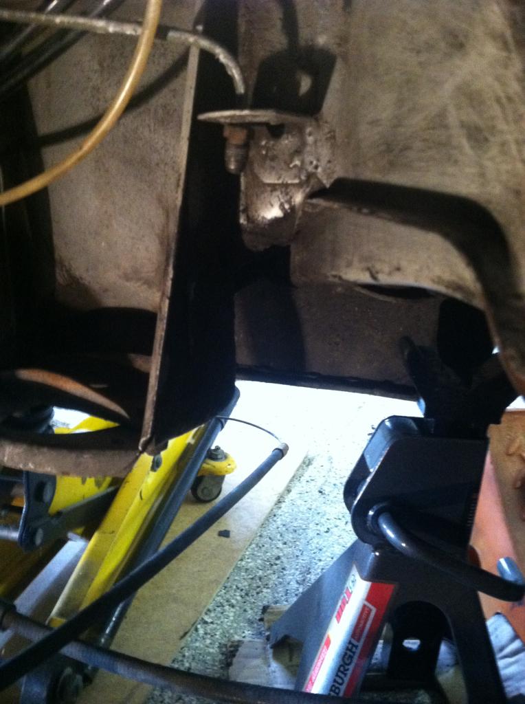

(IMG:http://www.914world.com/bbs2/uploads_offsite/i821.photobucket.com-16526-1410214116.1.jpg)

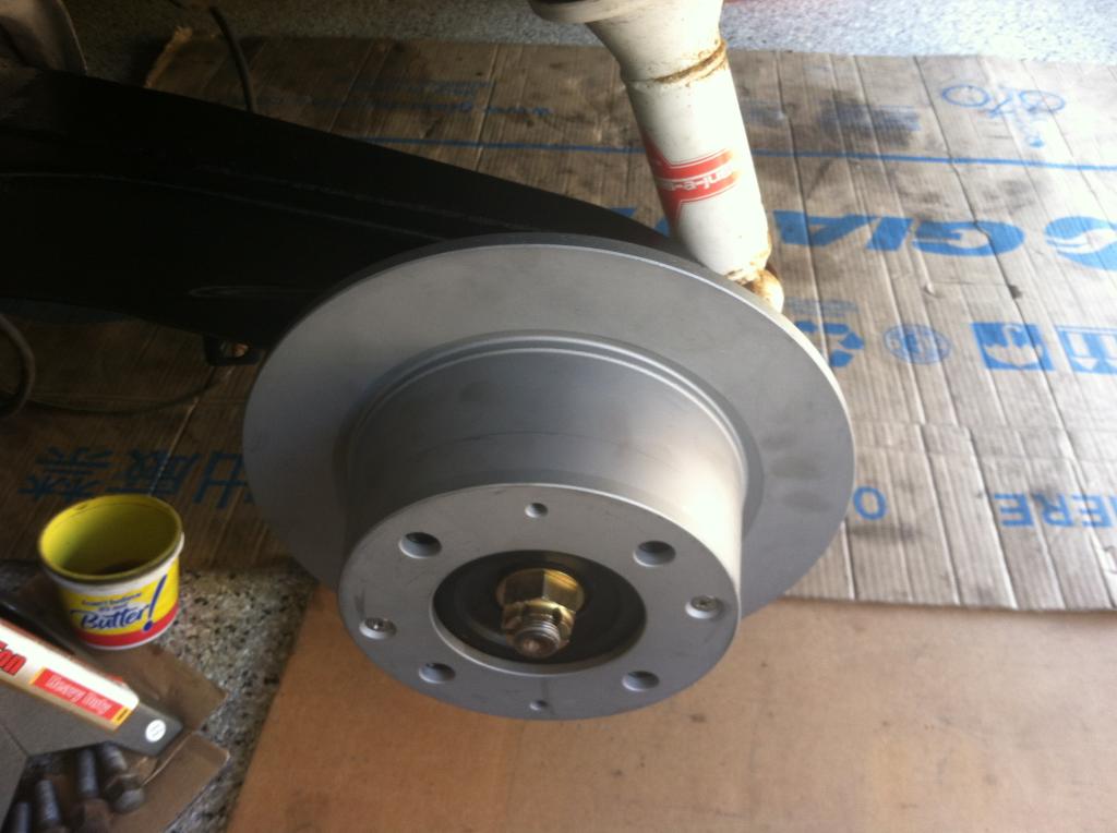

(IMG:http://www.914world.com/bbs2/uploads_offsite/i821.photobucket.com-16526-1410214117.2.jpg)

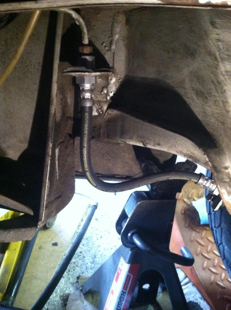

(IMG:http://www.914world.com/bbs2/uploads_offsite/i821.photobucket.com-16526-1410214117.3.jpg)

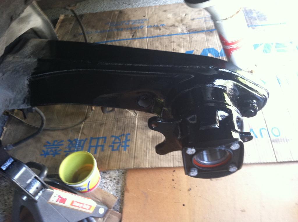

(IMG:http://www.914world.com/bbs2/uploads_offsite/i821.photobucket.com-16526-1410214118.4.jpg)

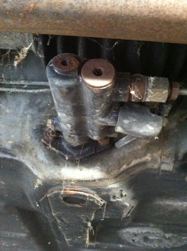

anyone recognize this master cyl though?
(IMG:http://www.914world.com/bbs2/uploads_offsite/i821.photobucket.com-16526-1410214118.5.jpg)

euro911   Original MCs were ATE with a 17mm bore. Getting a ...   Sep 11 2014, 09:32 AM
colingreene   I was told this was a 19? I dont know for sure tho...   Sep 11 2014, 09:48 AM
Dave_Darling   Look around on it for numbers. There should be a ...   Sep 11 2014, 04:20 PM
