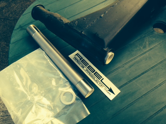

I need to replace the rear wheel bearings, so "while I am in there" I will also tackle the bushings.
Rubber looks to be the OEM choice but is hard to find with the exception of the elephant racing kit that includes the shafts and install tools. $300+ I used the Elephant bushings on the front.
I found poly-graphite to be the least expensive < $20 for a set of 4 bushings only
With Delrin as the middle of the road choice. @ $50 for a set of 4 bushings only
So what is the +/- of each material? Can you throw a few vendors out there?

I finally got time to take some pictures of the Rebel Racing rear control arm bushings. There's a machined metal tube with the secret material inner bushings. The control arm shaft fits down the middle of the machined tube while gliding on the teflon inpregnated bushings.
So, these bushing are mythical no more! They exist! Attached ImageAttached Image

IanS   oooh shiny! Interesting one piece design rath...   Sep 16 2014, 12:00 PM
lonewolfe   oooh shiny! Interesting one piece design rat...   Sep 16 2014, 01:07 PM

lonewolfe   Yes, the threaded shafts that go through the RR m...   Sep 16 2014, 05:45 PM
malcolm2   Yes, the threaded shafts that go through the RR ...   Sep 16 2014, 07:00 PM

Racer Chris   Using factory shafts with precision bearing or bus...   Sep 16 2014, 09:15 PM
914_teener   Using factory shafts with precision bearing or bu...   Sep 16 2014, 09:34 PM

malcolm2   Do the PTFE inserts spin in the tube or are they...   Sep 18 2014, 12:03 PM
Racer Chris   2ndly I mentioned to him that the 2nd rebel ass...   Sep 18 2014, 12:56 PM
malcolm2   2ndly I mentioned to him that the 2nd rebel as...   Sep 18 2014, 03:16 PM

914_teener   Looks right. Just make sure that the thrust surfa...   Sep 18 2014, 12:48 PM
