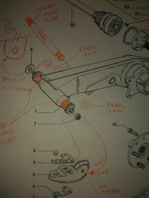

The phone just rang, Jonathon says the answer is JB WELD. They say they have done hundreds like that.
But still no written instructions. (IMG:style_emoticons/default/mad.gif)
I have some time while I wait on Bruce's carton and my new pivot arms, so maybe they will have some explicit instructions by the time it arrives.
Lots of good things said about Rebel Racing, but this JB weld thing seems half-assed to me. Internet research to come on that stuff, I guess.
I guess if I follow thru with the install, I'll video the whole thing and they (OR the 914World) can have it from YouTube. shouldn't I get a discount? (IMG:style_emoticons/default/piratenanner.gif)

When I got my rebel setup for the fronts I was feeling the same way about the jb weld, but trust me, it is the way to go. The issue is that the factory parts were not precise and the rubber bushings just took up the slop, when you are working with a non compressible material there is no way you can ensure a perfect fit on every car. On the fronts anyway the JB weld acted as a sort of filler between the sloppy control arm manufacturing and the precision machined race for the bushing. once together it is very clean.
You can see my install of the fronts here.
http://www.914world.com/bbs2/index.php?sho...211241&st=0
I am a little suspect of the shaft fit on the rear though, I thought they were going to provide new shafts machined to fit their bushings. as with the fronts the PTFE slides against a precision machined race, by the looks of the rear i would think it is intended to spin around a precision machined shaft to match (unless the PTFE spins inside that steel tube in which case you probably fasten the tube itself to the swing arm, and the PTFE inserts to the shaft).
Do the PTFE inserts spin in the tube or are they interference fit in?
Do you have pics of the shims for the thrust surfaces? That is the area I am most curious about.

Racer Chris   2ndly I mentioned to him that the 2nd rebel ass...   Sep 18 2014, 12:56 PM
malcolm2   2ndly I mentioned to him that the 2nd rebel as...   Sep 18 2014, 03:16 PM

914_teener   Looks right. Just make sure that the thrust surfa...   Sep 18 2014, 12:48 PM
lonewolfe   I am totally gung-ho on the Rebel Racing front con...   Sep 18 2014, 03:10 PM
