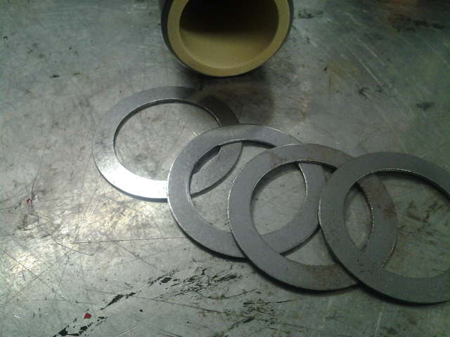

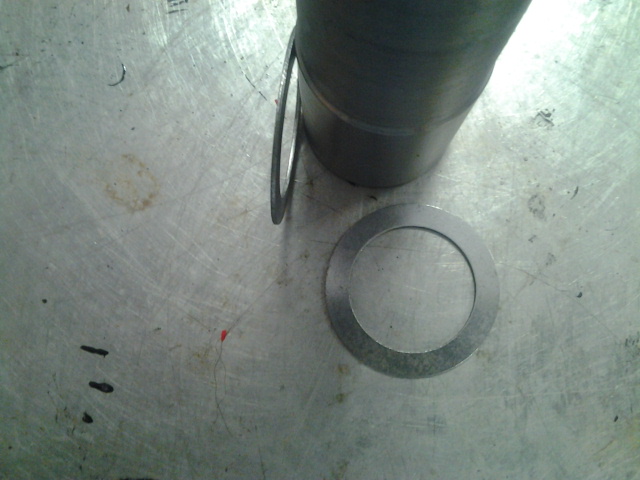

Do you have pics of the shims for the thrust surfaces? That is the area I am most curious about.

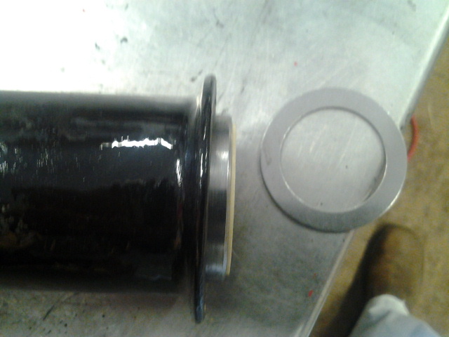

The PTFE inserts appear to be tight, I'll check that and also get a picture of the shim later today.
Below, I drew up a ruff idea of how Jonathon explained the install process to me.
2ndly I mentioned to him that the 2nd rebel assembly (not in the video) slipped in the top of the OEM arm but was very tight at the other end. He said, "no worries. Just add the JB WELD, then press the rebel assembly in, if needed."
I don't like that at all.
The welded end of the trailing arms is significantly out of round which will tend to squish the sleeve somewhat, making the bushing out of round.
I provide a sanding drum in my kits to prep inside the welded end - so the sleeve can be installed without causing deformation.
I checked the "tight" end with a snap gauge and it isn't out of round. It is just slightly smaller that the other 3 ends.
I am to the point that I am either going to have to intall these or send them back.
Before I made the purchase, there were several commenters that like the rebel product, but now I am leery and the commenters make sense. The only folks giving positive comments have only used the front bushings from these guys.
More pondering from me as I wind down with a cocktail. (IMG:style_emoticons/default/beer.gif)
I did take a few pictures of the shims. They are not very thick and the inner dia is slightly larger than the pivot arm, Also the overall length of the assembly when centered allows the tube to stick out about 3/16".
