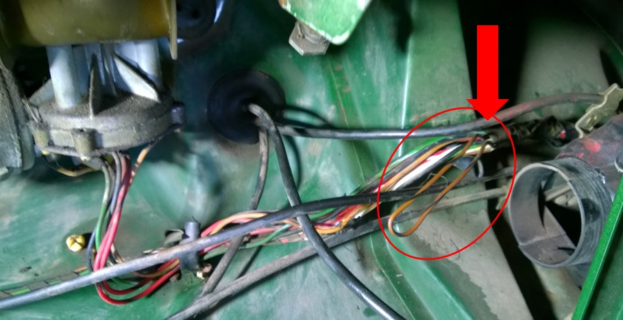

Anyway, I am looking for that extra, do-nothing wire that is "conveniently" located somewhere in the front trunk. Given that few things, if anything, are "convenient" on a 914, I am skeptical. Is this thing real or myth? Has anyone actually seen this wire or taken a picture of it?
Well, I did find this wire that matches the brown with black stripe as the unused "fifth" female connection on the steering column. In the picture below, the wire comes out of the harness and doubles back on itself into the harness. I can't find an extra wire on the pre '73 wiring diagrams although there is one marked on the later diagrams that matches this color.
So why would a wire double back on itself in the wiring harness? Did the engineers put that there with the intention of using an electric pump for the washer?

I believe that's it. Pin 5 was for the dealer intermittent wiper option.
Try unplugging your j connector from the base of the column and use a continuity tester (very different from a test light I might add). If you don't have one ya can borrow mine. Or I guess you could use a test light on it and see if activating your washer lights up the light....

Bing! Bing! Bing! We have a winner, Dave. I went ahead and cut that wire and I get 12V when pulling back on the wiper switch. Ok, this is good progress. Now I just need to wire up, secure the pump, and I'm on my way. As a bonus, I took out the fresh air blower and got that working again after cleaning the crap out of it.
