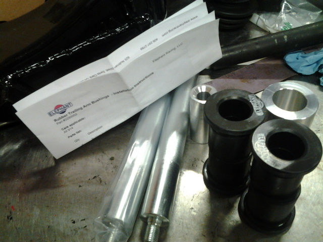

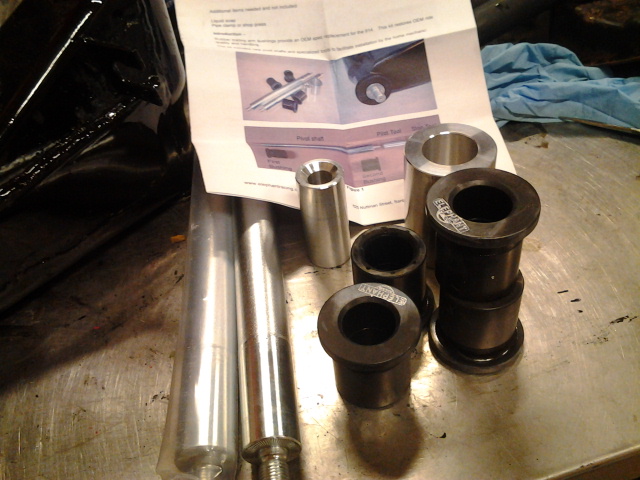

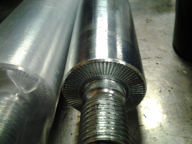

UPDATE: Rebel stuff has been returned and my VISA has been credited. Today the elephant stuff arrived from PMB.
UPS from Cali to TN really sucks. Obama only takes 2 days and UPS takes about 6.
But it is here and it has instructions and tools to install the RUBBER BUSHINGS and NEW PIVOT ARMS. I am fired up about getting this done.
I didn't bring it up this weekend, but with all those cars driving around in that grass field in Townsend, TN I heard quite abit of squeaking. (IMG:style_emoticons/default/blink.gif)
Anyway here are a few pictures of the new Elephant stuff.
Attached ImageAttached ImageAttached Image
