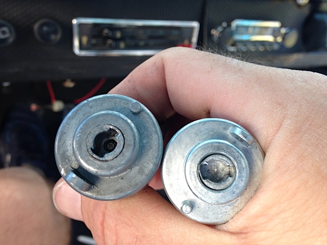

2nd issue: With the new part (on right) rotating part does not line-up in the same way as the old part. ( left ) The pin and the rotating part do not align in the lock cylinder, the new part does not "seat-in" When I attempted to install it got a bit smushed ( see photo ) Then I discovered it is wrongly aligned to the spec's old part. My car is a 1971 so it has some differences to the later years.. Might this new part might be for the 72/73-76 model years? |

Kraftwerk Ok so the part arrives and it has two major
Differ... Sep 23 2014, 11:41 AM

Kraftwerk
Here is the 1st issue I have with the replaceme... Oct 13 2014, 01:30 PM
Kraftwerk So that is when I got adventurous and decided just... Oct 13 2014, 01:45 PM
Kraftwerk Here is another shot of the parts inside, incase y... Oct 13 2014, 01:48 PM
