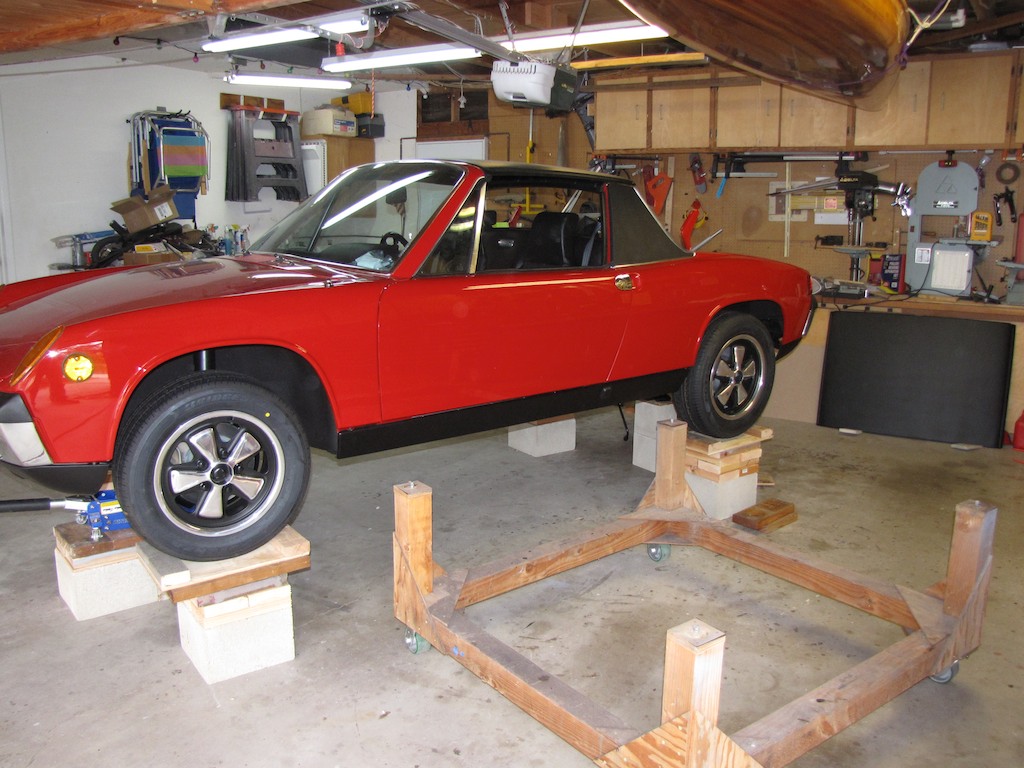

Hi, I would like to introduce myself and share my project. I’m Steve, I live in San Diego and I picked up this 1973 1.7 914 about a year ago. It was in great shape with no rust and had been sitting in a garage for the past 13 years. My plan is to restore it to its original condition. At this point I think the car is about 50% done.
The car had door guards riveted to the sides and I had them welded up. One of the first things I did when I got the car was to build a dolly to be able to work on the suspension and make it easy to move it around the garage. It’s made from 4 X 4s and plywood and it took about 4 hours to build. If you don’t have a wood saw Home Depot will cut the 4 X 4s and plywood to the correct length. There are lag screws on top of the vertical posts that stick up ½” that fit into the 4 jack points cups under the car. This keeps the car from falling off. Also, I removed the engine before I put the car on it. To get it up there I used some cement blocks, 4 jack stands and 2 scissor jacks.
Over the past year I’ve learned a lot from reading your posts and now I would like to give back some of the knowledge I’ve learned.

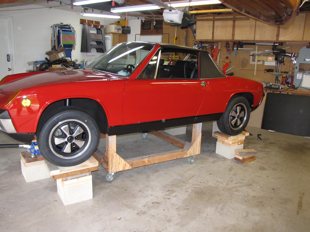

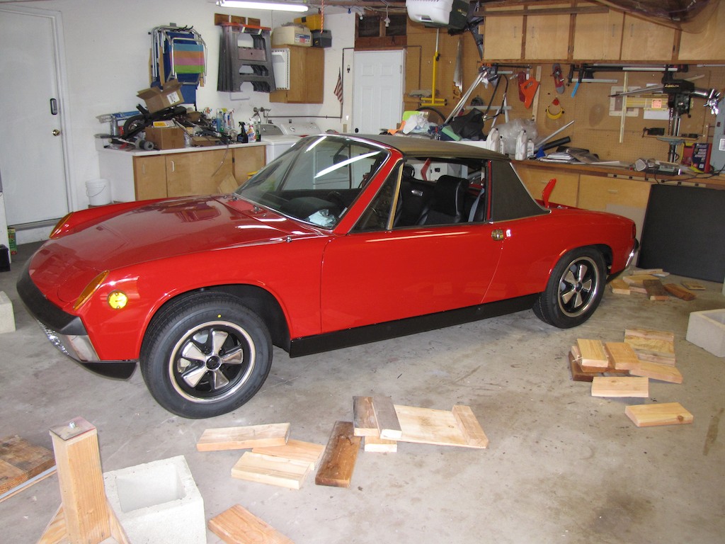

It's been a while since I've posted any pictures. So, here are some removing the dolly.
