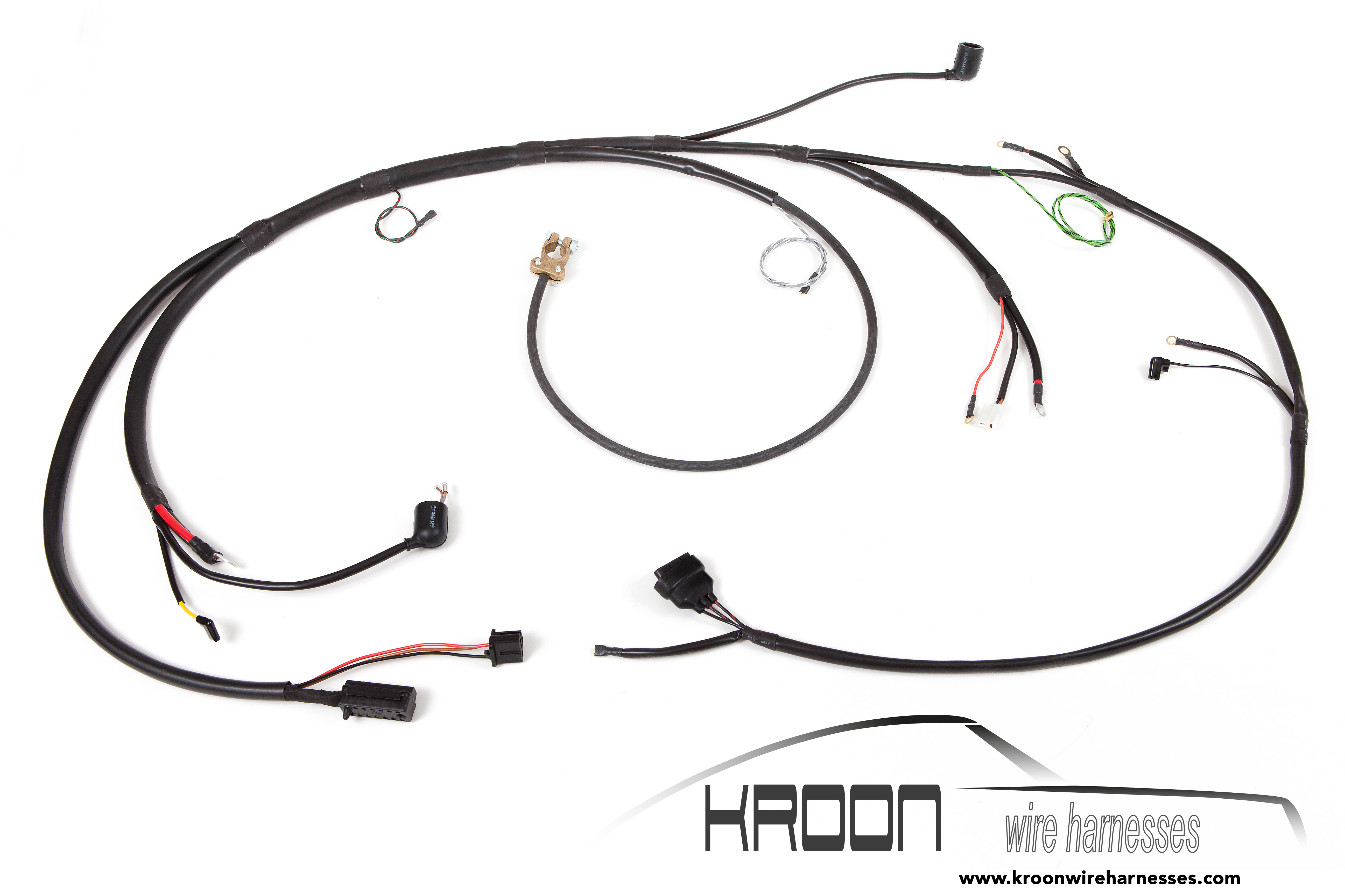

We have been working on our first 1970 914-6 for several weeks now. Many hours are spend on documenting and measuring. We always include our own installation drawings and only that took more than a week. A 914 harness is much more complicated than a 911 of the same year. As a comparison,the most time consuming harness is a 1969 911 E or S, i would say a 914-6 is 1,5 times more complicated. At this moment only the engine harness is finalized,and we will start with producing the main harness soon which we expect to have ready within a month from now. Because producing 911 and 356 harness is our daily job we have an enormous amount of color combinations on stock. Getting the color and diameters combinations in not really an issue, but getting all wire in the right quality is. More picture's will follow on our website soon. Anyone who needs more information can contact me at info@kroonwireharnesses.com.
Best regards from Holland,
Gerard Kroon

gerakroo   Finally ready, our first 914-6 main and engine har...   Oct 27 2014, 05:22 AM

gerakroo   Does the main harness come with all the available...   Oct 28 2014, 09:17 AM
