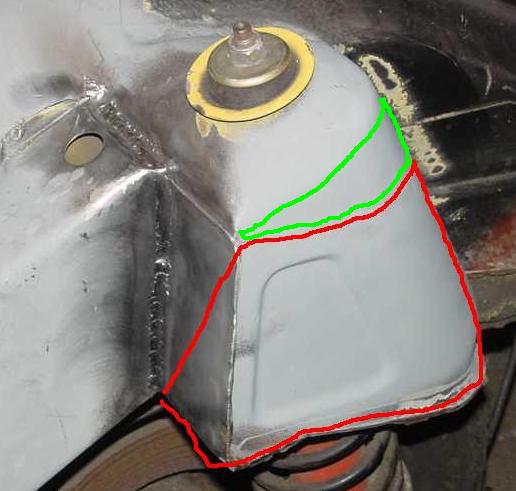

Thanks to Jeroen's thread I decided to cut away the body seam sealer and have a look at how the shock towers are fastened (not fastened?) to the body.Brad & Jeroen I can see how they would tear away after a while with stiff springs and racing stresses. (IMG:style_emoticons/default/smash.gif) Here are a couple of pics..........

Could even more of that shock tower come off? Like the part in red, or even the green? Doesn't the x-member only need to tie the tops of the shocks together and just a little is needed for supporting the tranny?

Cloudbuster   Could even more of that shock tower come off? Lik...   Aug 23 2004, 06:40 PM
