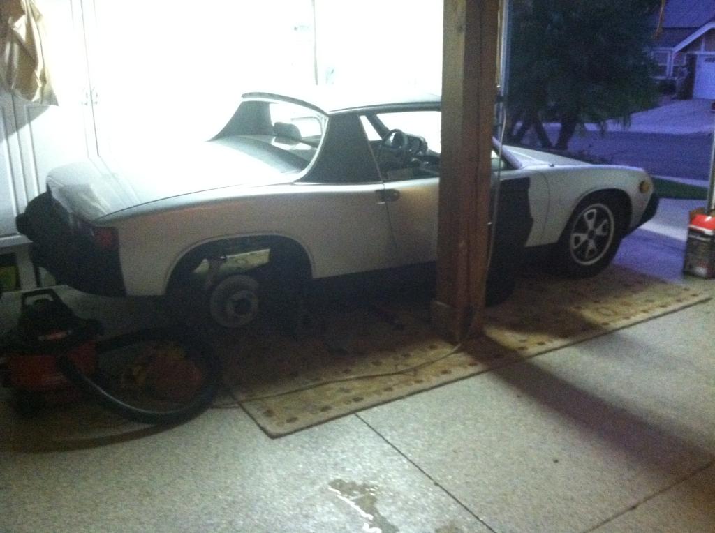

I just picked up a 1976 914 2.0
for
500$ seriously.
Problem is as you can see in this picture.
(IMG:http://www.914world.com/bbs2/uploads_offsite/i821.photobucket.com-16526-1383243790.1.jpg)
It needs a bit of work.
the previous owner used this car as a daily driver till the clutch delaminated. he then removed the motor took the trans appart and well, lost interest.
his mess is now my problem
However it could be worse, its a clean straight car and its got most if not all of its paint on it.

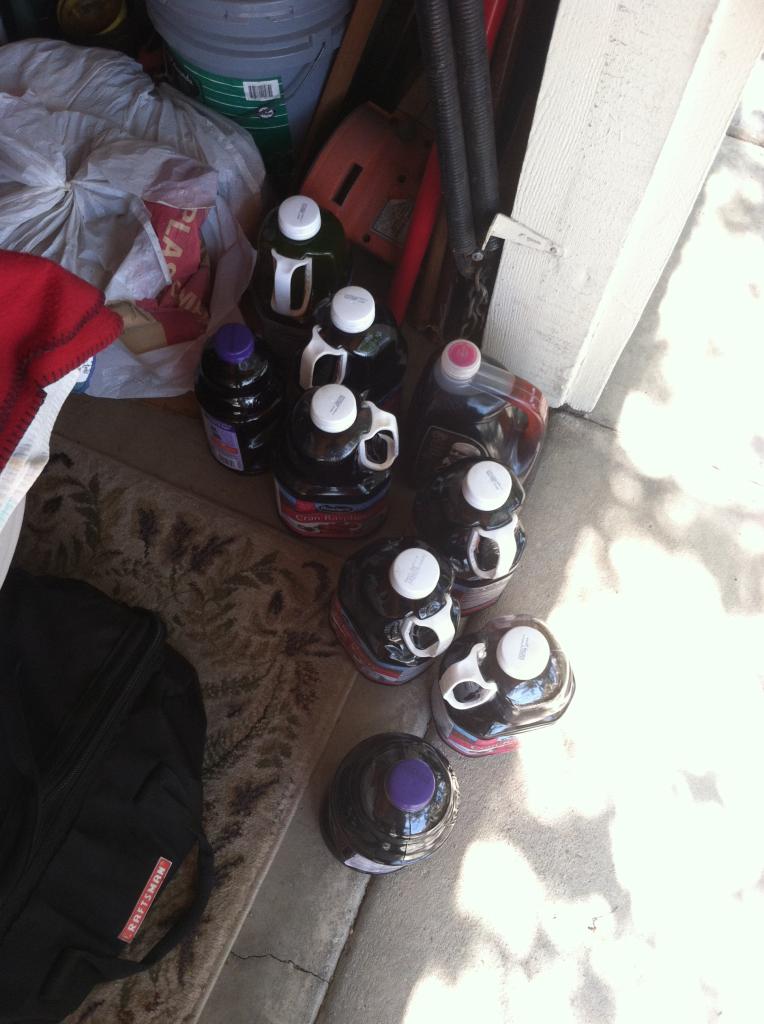

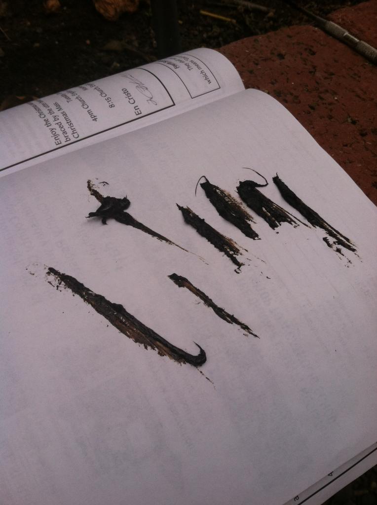

Whats left of the 14 year old gas that was in my old tank, thats also borked.

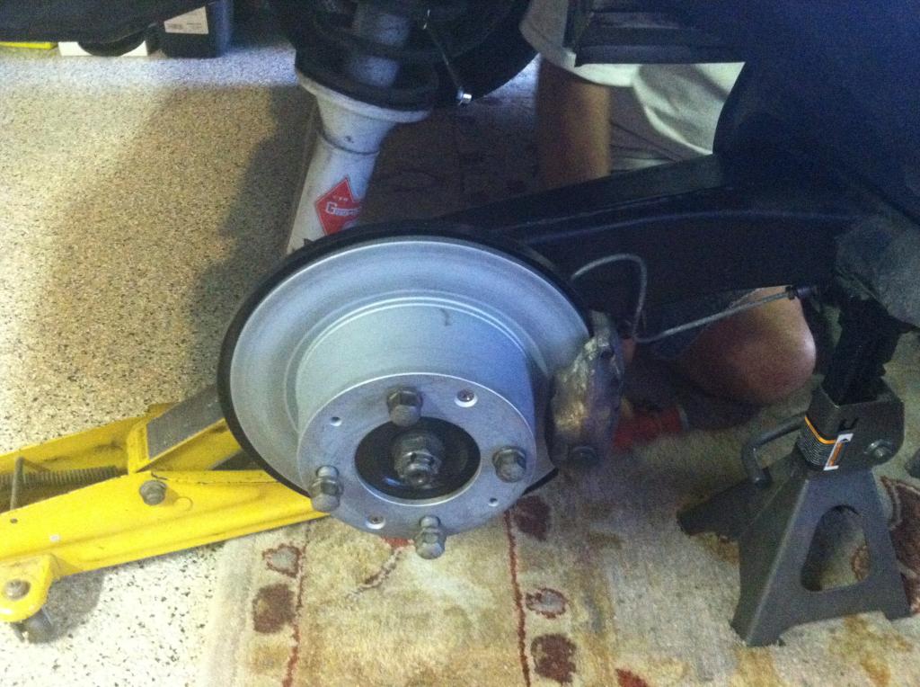

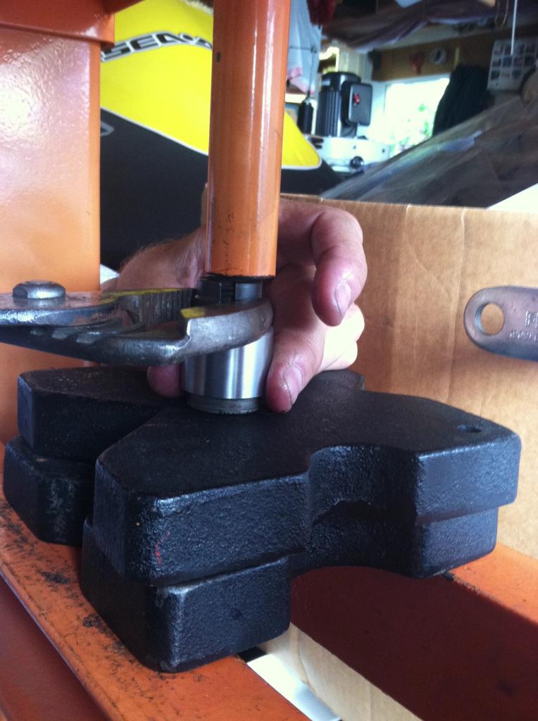

rear brakes needed to be rebuilt since they did not want to have a working hand brake, also one of the cables was freying, good thing i have a press at home, had to press the adjuster back into the piston.
Thanks to Eric for the parts to do that. hes honestly awesome for all the help he gave me ill always appreciate that.
(IMG:http://www.914world.com/bbs2/uploads_offsite/i821.photobucket.com-16526-1413915154.5.jpg)
(IMG:http://www.914world.com/bbs2/uploads_offsite/i821.photobucket.com-16526-1413915154.6.jpg)
Got those on and bled.

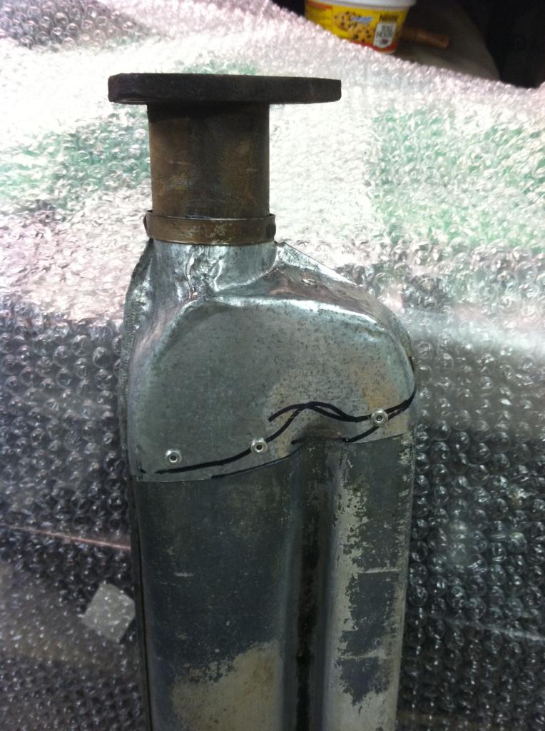

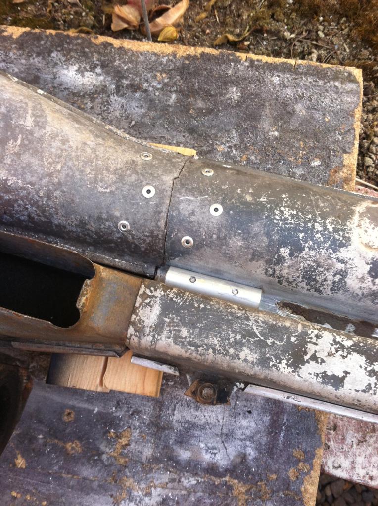

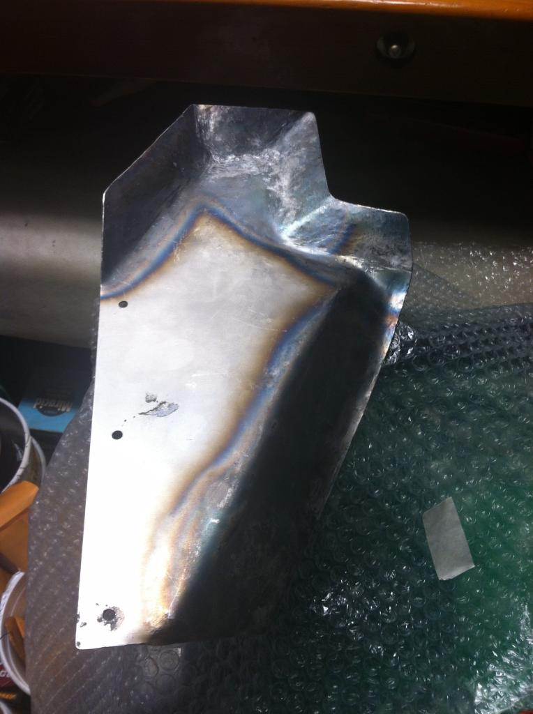

Heat exchangers, Mine of course were cracked and poorly repaired.
so cue the music and heres the next project.
all finished up, Had to beat some galvanized sheet metal to form to the end, and used some aluminum bar stock to pull the case halfs together and give it some rigidity.

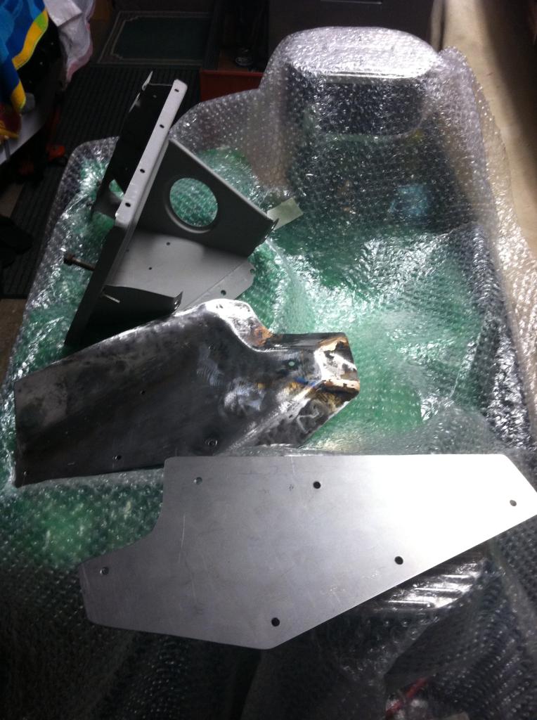

Now back to the battery tray issue.

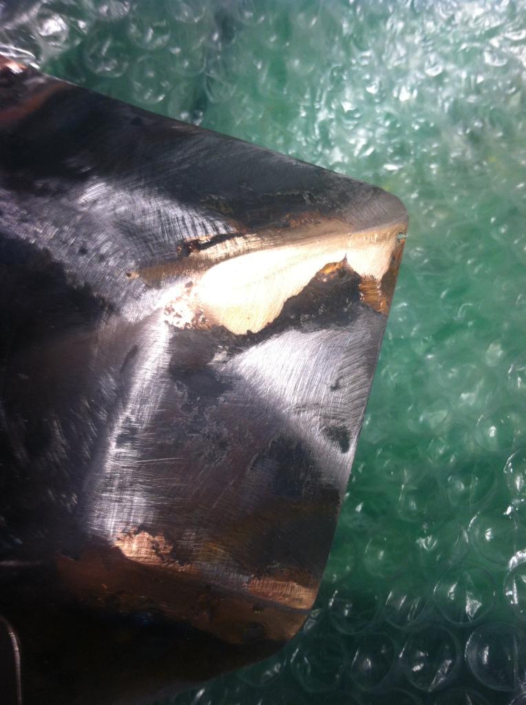

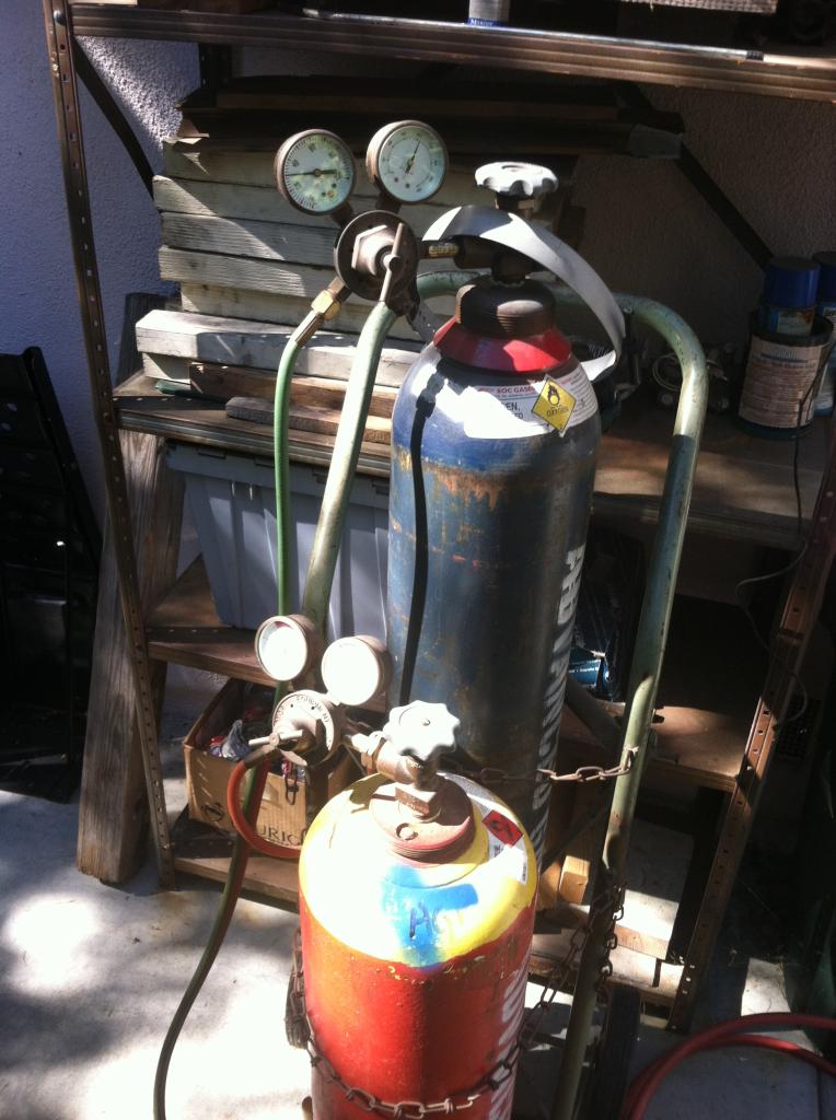

Everyone knows I like to hit things with a hammer, so that skill ( If you want to call it that) worked out great for this next bit.
because I lack a welder at home and i did not want to cut the fender off the car and the side of the engine bay out i elected to put a patch in, obviously because someone hates me (i know who) the firewall where the battery tray is not flat. Means i had to make this.
(IMG:http://www.914world.com/bbs2/uploads_offsite/i821.photobucket.com-16526-1413915155.10.jpg)
used this to braze the corners where the metal needed to be brought in.
(IMG:http://www.914world.com/bbs2/uploads_offsite/i821.photobucket.com-16526-1413915156.11.jpg)
(IMG:http://www.914world.com/bbs2/uploads_offsite/i821.photobucket.com-16526-1413915156.12.jpg)

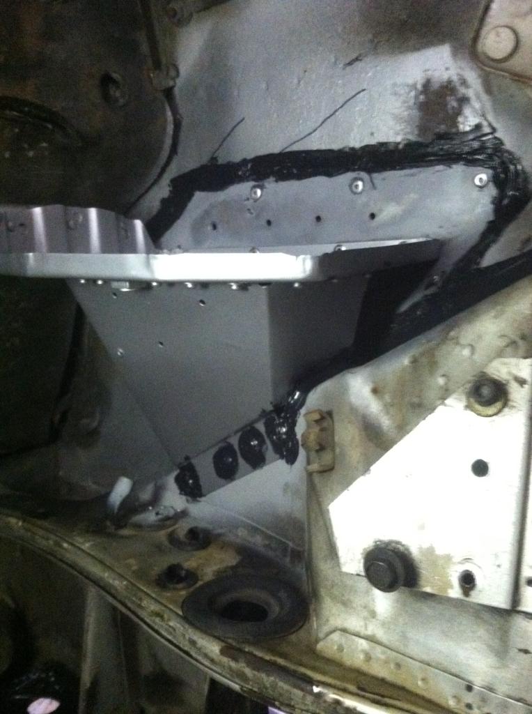

ill be honest, i just bought a new battery tray, re attached my original ECU bracket to it and blasted and re painted my battery stand and stuck that all sort of together.
the other spare part you see in this picture is the patch to go on the wheel well side of the firewall, and thats flat. who knows why.
i used a sealant and more rivets than i probably needed to hold it all together.
(IMG:http://www.914world.com/bbs2/uploads_offsite/i821.photobucket.com-16526-1413915157.13.jpg)
And finished off, before paint.

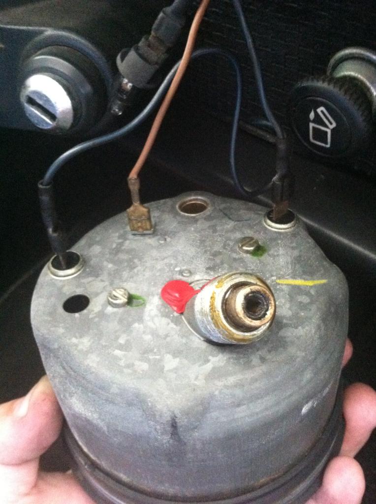

Of course all hell broke loose when i had to change the speedo cable.
Since my car is a 76 it means its subject to californias emissions standards of the time.
it had a cat and it had a oxygen sensor. Not anymore! but weirdly that means i have a retarded speedo cable set up. It feeds from the trans to a box in the passenger footwell then to the speedo.
Homie dont play dat.
I just bypassed it. however it required some interesting perspective to get the work done.
(IMG:http://www.914world.com/bbs2/uploads_offsite/i821.photobucket.com-16526-1413915158.15.jpg)
(IMG:http://www.914world.com/bbs2/uploads_offsite/i821.photobucket.com-16526-1413915158.16.jpg)
I cant say that was fun to stuff though the center tunnel.
