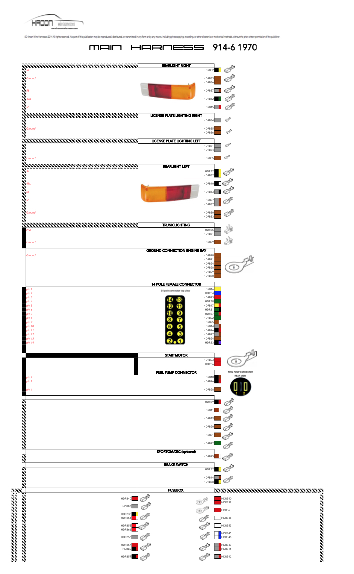

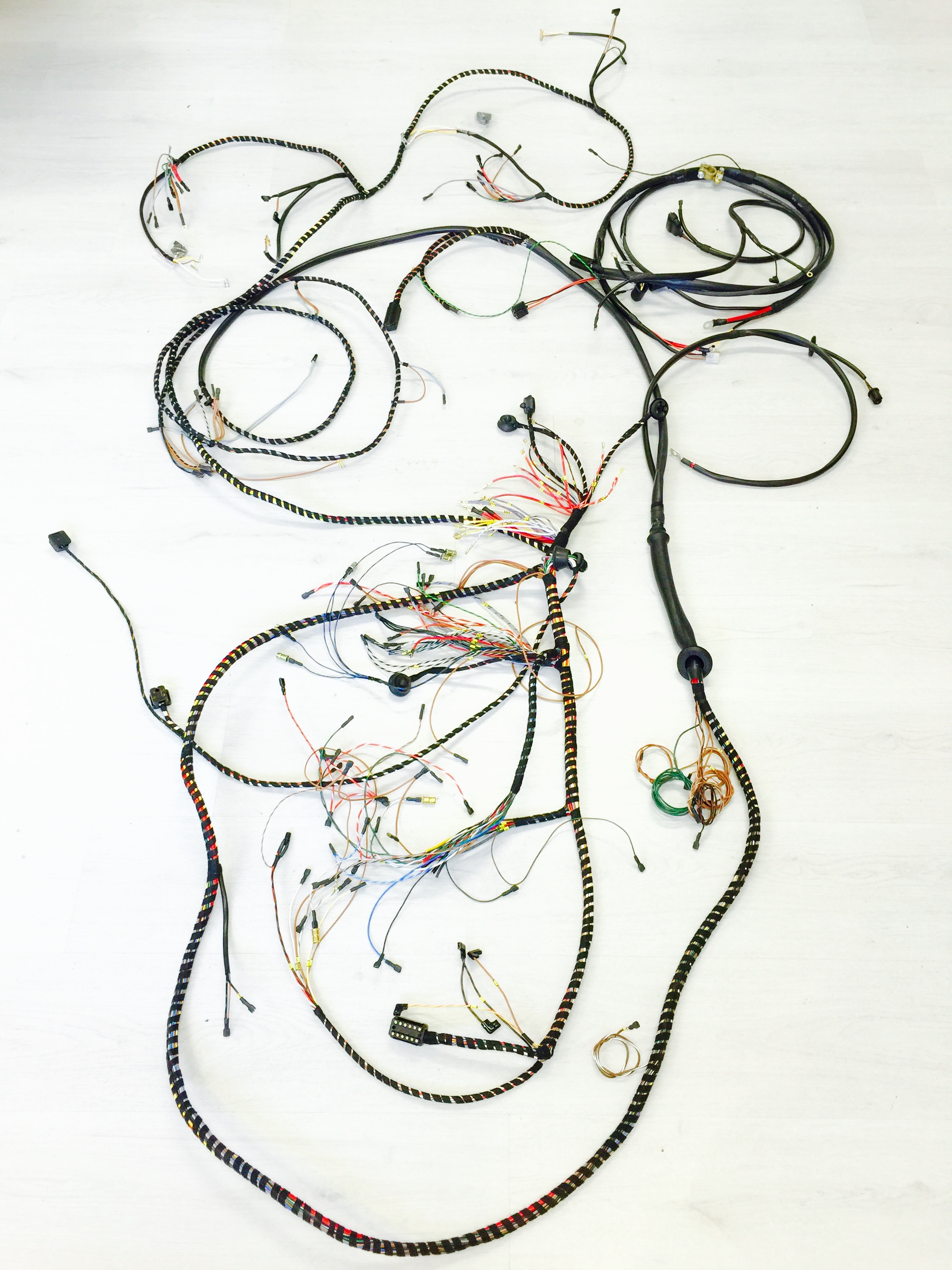

Finally ready, our first 914-6 main and engine harness set.
Detailed drawings are included, showing each to be connected wire and component.
Anyone who's interested can contact me at info@kroonwireharnesses.com.

gerakroo   We have been working on our first 1970 914-6 for s...   Oct 19 2014, 10:34 PM

gerakroo   Finally ready, our first 914-6 main and engine har...   Oct 27 2014, 05:22 AM
altitude411   YES! Nice work. :Qarl: What is the projected...   Oct 27 2014, 07:01 AM
Luke M   Does the main harness come with all the available ...   Oct 27 2014, 01:37 PM
gerakroo   Does the main harness come with all the available...   Oct 28 2014, 09:17 AM
