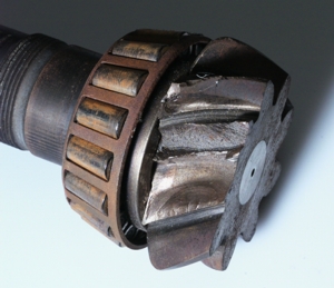

So I recently installed by rebuilt tranny after the PNW tranny clinic. I also converted from tail to side shift, and all the bushings. The previous owner (40 yrs) rebuilt the engine after 97k miles in 2007, but afaik did nothing on the tranny. The bushings were shot. Last weekend, after logging 120 test miles around Central Oregon, I thought I'd take her down to the Bay Area. About 130 miles into the trip, I hear a loud bang and spin a 360 into the ditch. During the fun, I figured I had a blowout. But not tire problems just a locked up rear differential.
I pulled the tranny and this is what I saw. (Please excuse the large photos, but it adds detail)
So I opened up the tranny case and found some interesting stuff.

Classic example of tooth-root crack propagation.
Ask any A+P if a visual inspection is enough.
Magnaflux,X-ray,ultrasonic,penetrant methods are required.
Even then..

Hank914   So, any ideas on... 1). :WTF: made that piece d...   Nov 3 2014, 12:33 AM
Dave_Darling   2) Not very often! 3) In very high-torque appl...   Nov 3 2014, 01:20 PM

jkb944t   I don’t see any gulling of the remaining section...   Nov 5 2014, 12:05 PM
Hank914   I don’t see any gulling of the remaining sectio...   Nov 5 2014, 01:12 PM

Dr Evil   Whats the diff look like? A sheared roll pin at th...   Nov 7 2014, 09:32 AM
Hank914   Whats the diff look like? A sheared roll pin at t...   Nov 7 2014, 09:42 AM
Dr Evil   Nah, save the money on shipping unless you really ...   Nov 7 2014, 09:48 AM

Hank914   More pics. The big piece is from the pinion. The ...   Nov 7 2014, 04:43 PM
Hank914   The differential. The quarter is for reference onl...   Nov 7 2014, 04:50 PM
SirAndy   And now some close ups :unsure:   Nov 7 2014, 04:53 PM
Hank914   Here is a pic of the quarter next to the other sid...   Nov 7 2014, 04:53 PM
Dr Evil   How about the guts of the diff? I expect the gear ...   Nov 7 2014, 05:24 PM
Hank914   Guts looked clean. Both bearings spin freely. Pi...   Nov 7 2014, 05:32 PM

Dr Evil   Interesting. Such damage done by one tooth from th...   Nov 8 2014, 05:21 AM
Dr Evil   Well, I have received and have have had time to go...   Dec 6 2014, 12:38 AM

Dr Evil   The failed bearing was a needle bearing and not on...   Dec 6 2014, 04:29 PM
