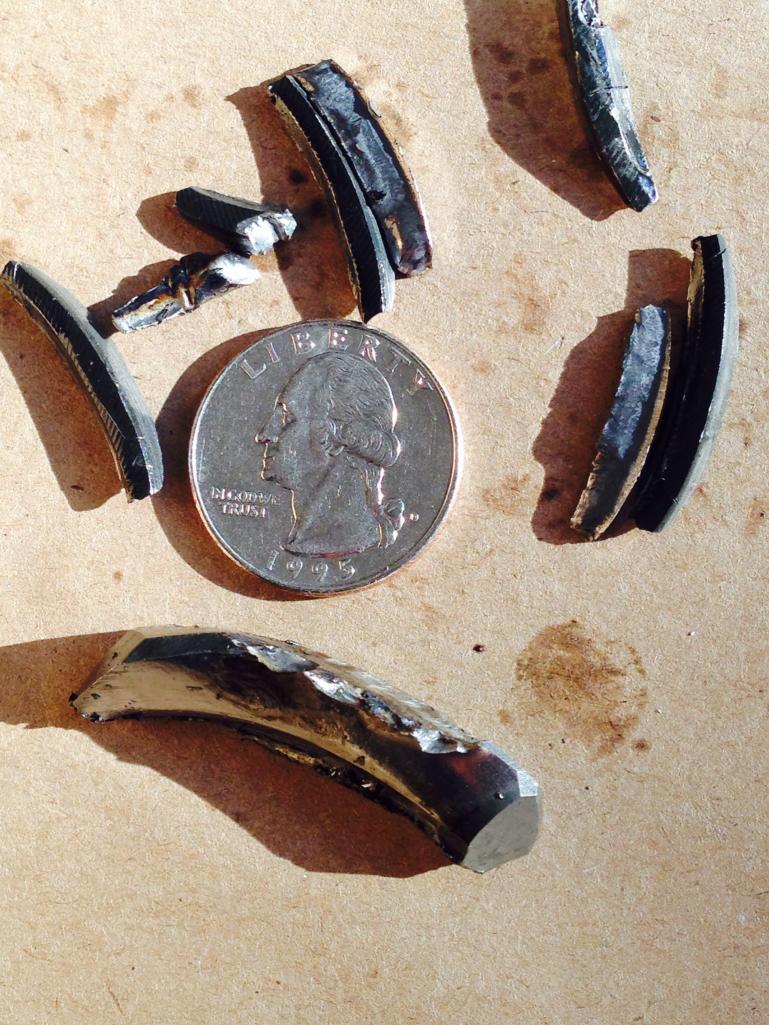

More pics. The big piece is from the pinion.
The small pieces are from the diff. 15 outta 31 teeth shredded. Attached Image

Hank914   More pics. The big piece is from the pinion. The ...   Nov 7 2014, 04:43 PM

Dr Evil   How about the guts of the diff? I expect the gear ...   Nov 7 2014, 05:24 PM
Hank914   Guts looked clean. Both bearings spin freely. Pi...   Nov 7 2014, 05:32 PM
