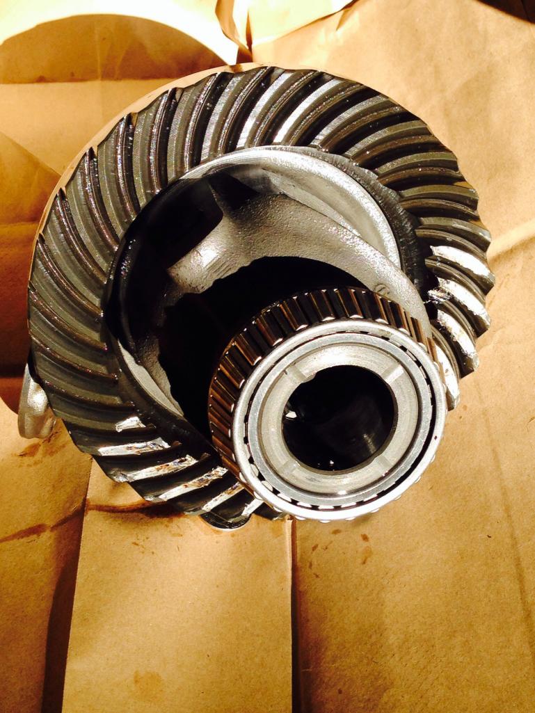

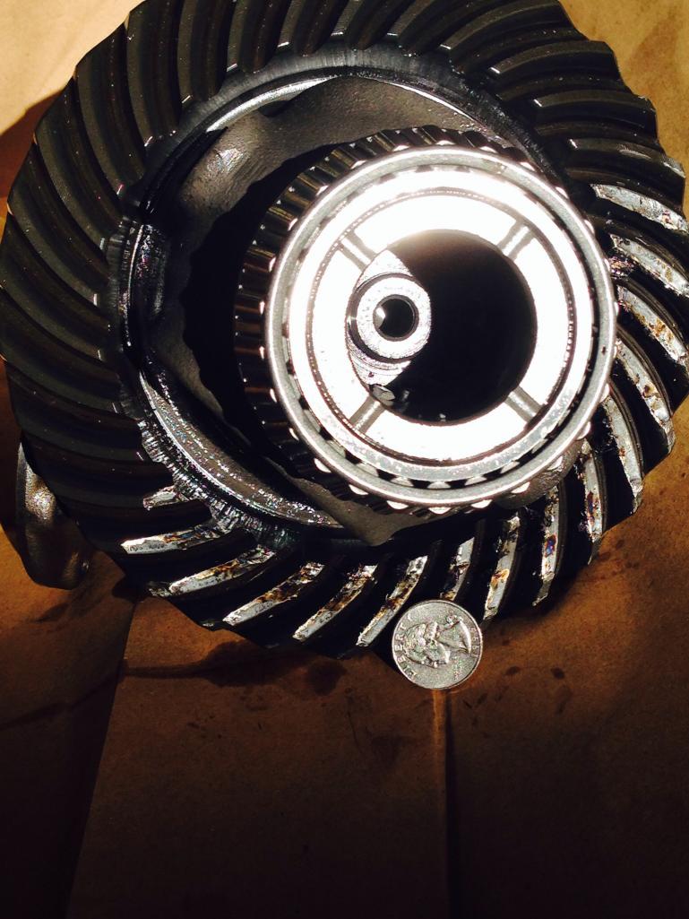

The differential. The quarter is for reference only. It was not in the transaxle.

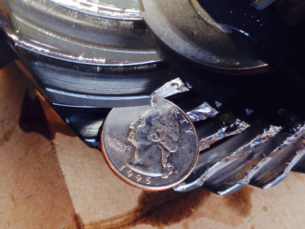

And now some close ups.
The quarter is underneath the first (or last?) broken tooth on the diff.

Hank914   The differential. The quarter is for reference onl...   Nov 7 2014, 04:50 PM
SirAndy   And now some close ups :unsure:   Nov 7 2014, 04:53 PM
Hank914   Here is a pic of the quarter next to the other sid...   Nov 7 2014, 04:53 PM
