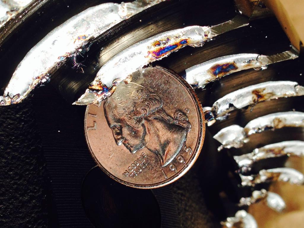

Here is a pic of the quarter next to the other side of the diff, where the teeth broke. Attached Image

Dr Evil   Interesting. Such damage done by one tooth from th...   Nov 8 2014, 05:21 AM
