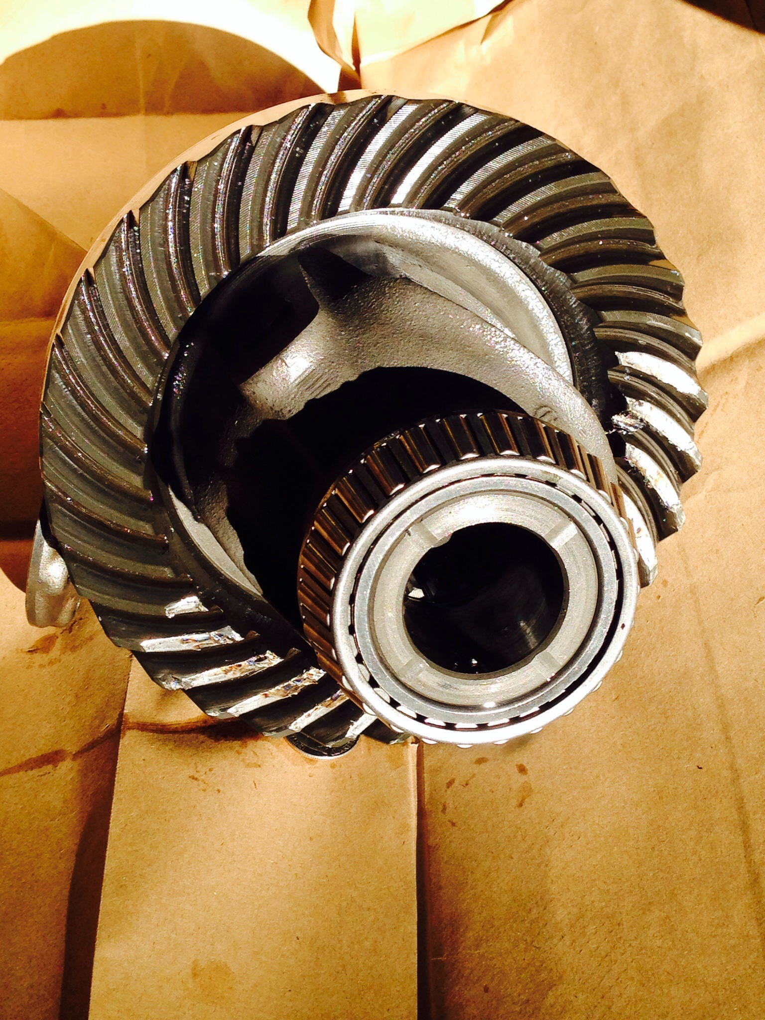

The differential. The quarter is for reference only. It was not in the transaxle.
And now some close ups.
The quarter is underneath the first (or last?) broken tooth on the diff.

QUOTE(Hank914 @ Nov 7 2014, 02:50 PM) *
(IMG:style_emoticons/default/unsure.gif)

Hank914   More pics. The big piece is from the pinion. The ...   Nov 7 2014, 04:43 PM
Hank914   The differential. The quarter is for reference onl...   Nov 7 2014, 04:50 PM
SirAndy   And now some close ups :unsure:   Nov 7 2014, 04:53 PM
Hank914   Here is a pic of the quarter next to the other sid...   Nov 7 2014, 04:53 PM
Dr Evil   How about the guts of the diff? I expect the gear ...   Nov 7 2014, 05:24 PM
Hank914   Guts looked clean. Both bearings spin freely. Pi...   Nov 7 2014, 05:32 PM

Hank914   Pics galore.   Nov 7 2014, 05:43 PM
Hank914   More   Nov 7 2014, 05:46 PM
Hank914   Last two I think this bearing is usable.   Nov 7 2014, 05:50 PM
