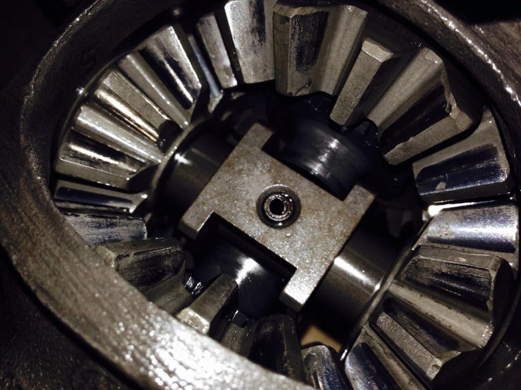

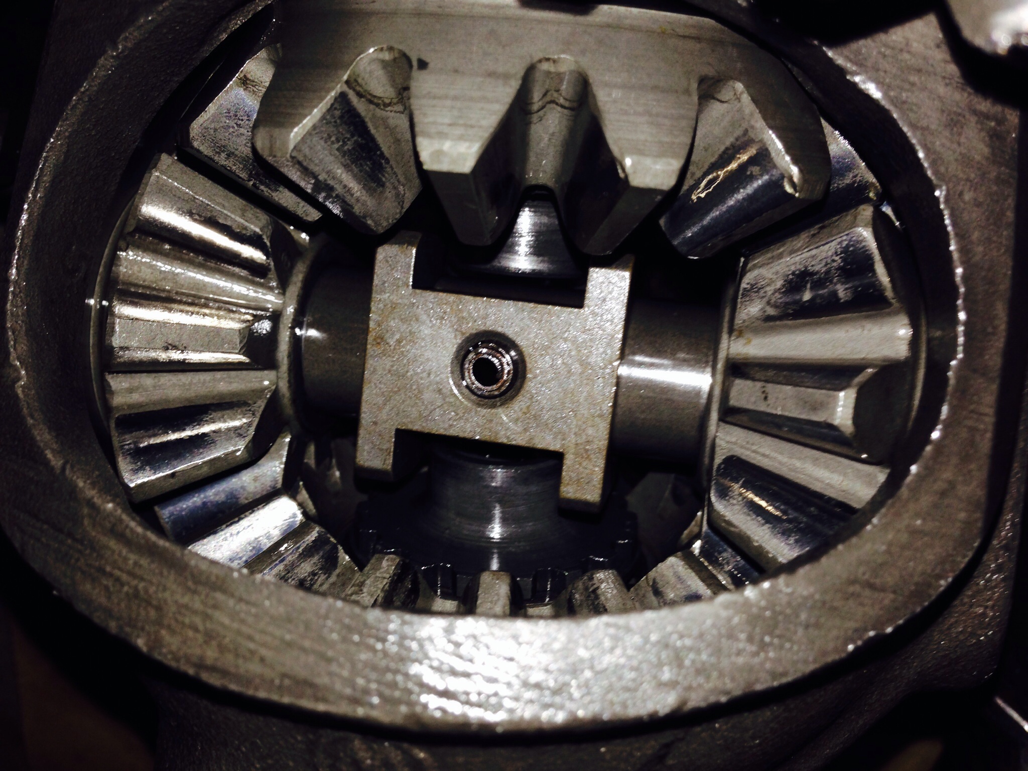

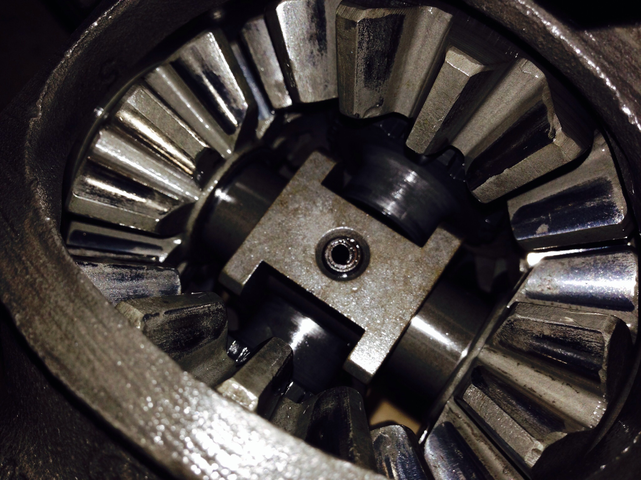

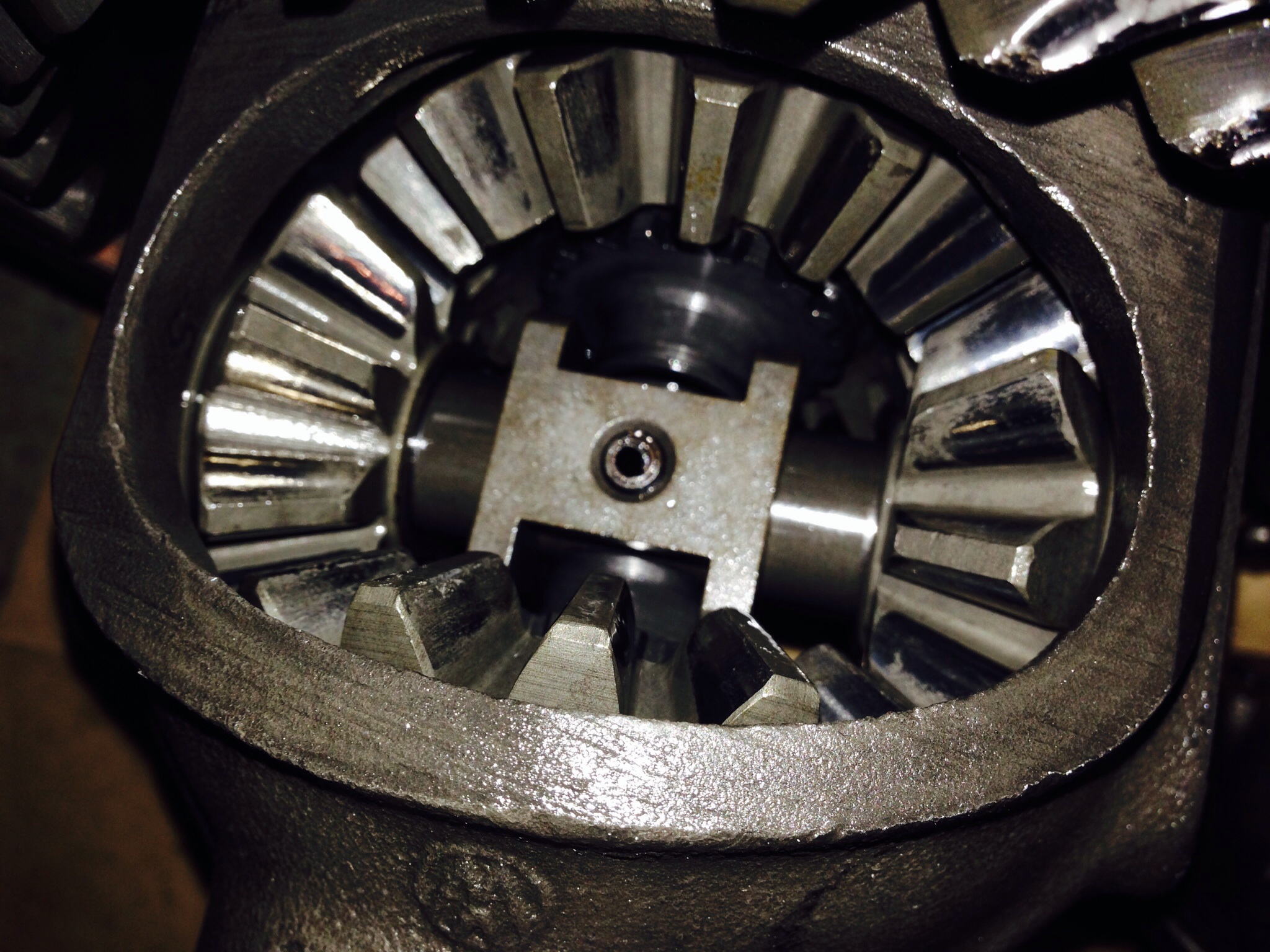

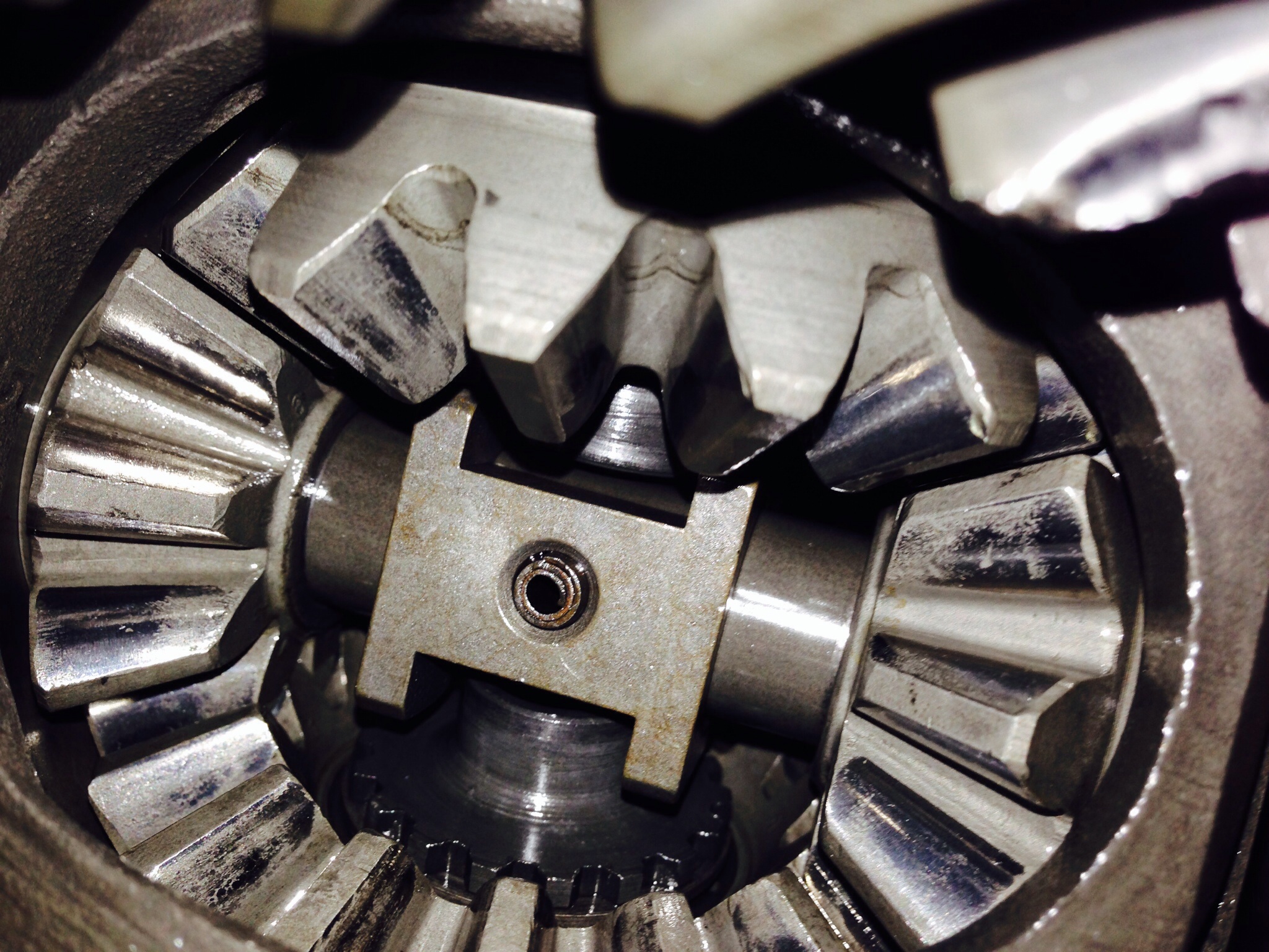

Hank914   More pics. The big piece is from the pinion. The ...   Nov 7 2014, 04:43 PM
Hank914   The differential. The quarter is for reference onl...   Nov 7 2014, 04:50 PM
SirAndy   And now some close ups :unsure:   Nov 7 2014, 04:53 PM
Hank914   Here is a pic of the quarter next to the other sid...   Nov 7 2014, 04:53 PM
Dr Evil   How about the guts of the diff? I expect the gear ...   Nov 7 2014, 05:24 PM
Hank914   Guts looked clean. Both bearings spin freely. Pi...   Nov 7 2014, 05:32 PM
Steve   :hide: Maybe that quarter caused it!! Ju...   Nov 7 2014, 05:37 PM
Hank914   Pics galore.   Nov 7 2014, 05:43 PM
Hank914   More   Nov 7 2014, 05:46 PM
Hank914   Last two I think this bearing is usable.   Nov 7 2014, 05:50 PM
