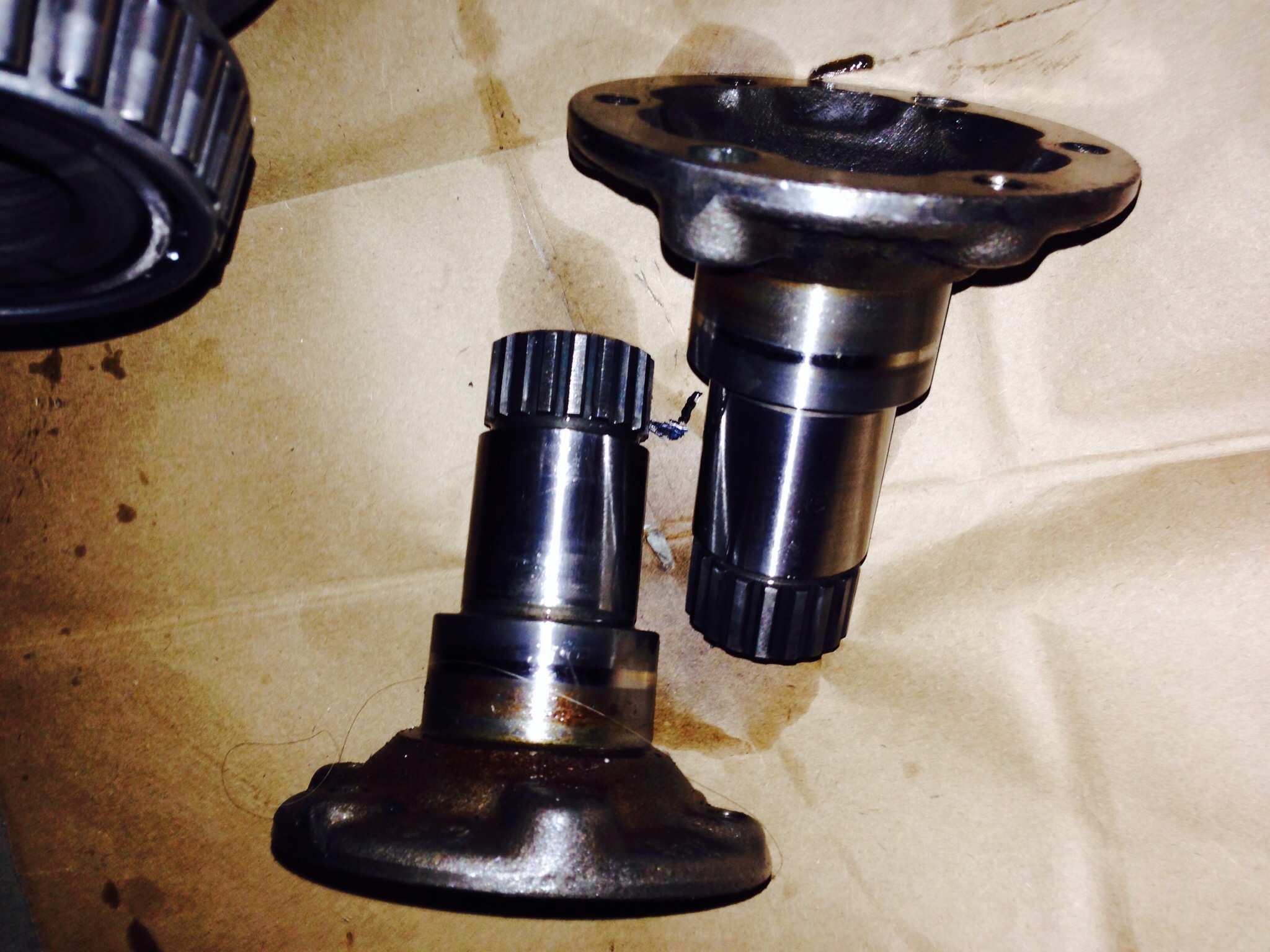

No need for any of the clips, just as long as the races come with the stack. I will make sure they are good to go as it would such to toss new bearings if not necessary.
When I was asking or guts, I meant the spider gears and shaft INSIDE of the diff (IMG:style_emoticons/default/wink.gif)

QUOTE(Dr Evil @ Nov 7 2014, 05:19 PM) *
Oh....

QUOTE(Hank914 @ Nov 7 2014, 09:59 PM) *
Oh....
Those all looked fine, spun them around and saw no damage.
