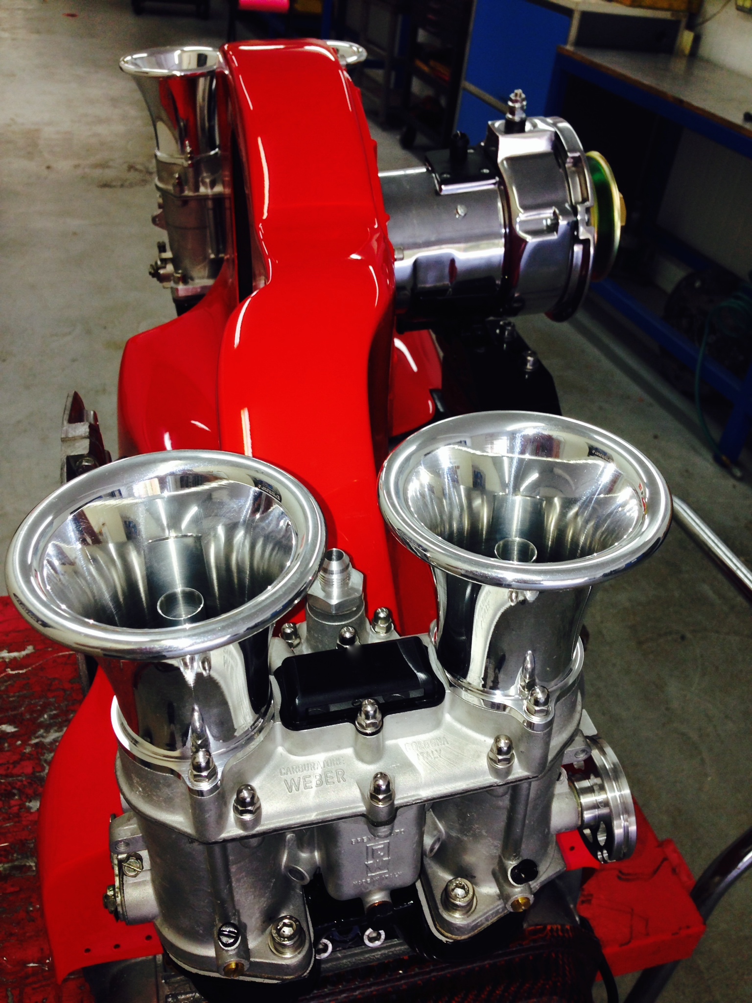

Here's the 2.6L MassIVe engine thats in my 356. It has LE 220 heads, 10:1, roller camshaft/ lifters and lots of other tricks. It optimized fairly well with the 52mm Bologna IDAs pictured, with a 40mm venturi. it made more power on the dyno with 45mm Dellortos with a 42mm venturi.
That said, these carbs will not be on the car for that long, because like all IDAs, even with a 3rd progression hole they lack serious drivability.
I've had these carbs for over 25 years, and I wanted to use them for the 356, but I am seriously not about bling, and much prefer the Dells.
I've only had one T4 like an IDA better than an IDF or DRLA, that was the 3 liter twin plug roller engine in Beth's vert that made 250HP on 89 octane fuel, using these same 52mm IDAs.
I can't sleep well at night if something isn't optimized, I don't give a damn about bling.
