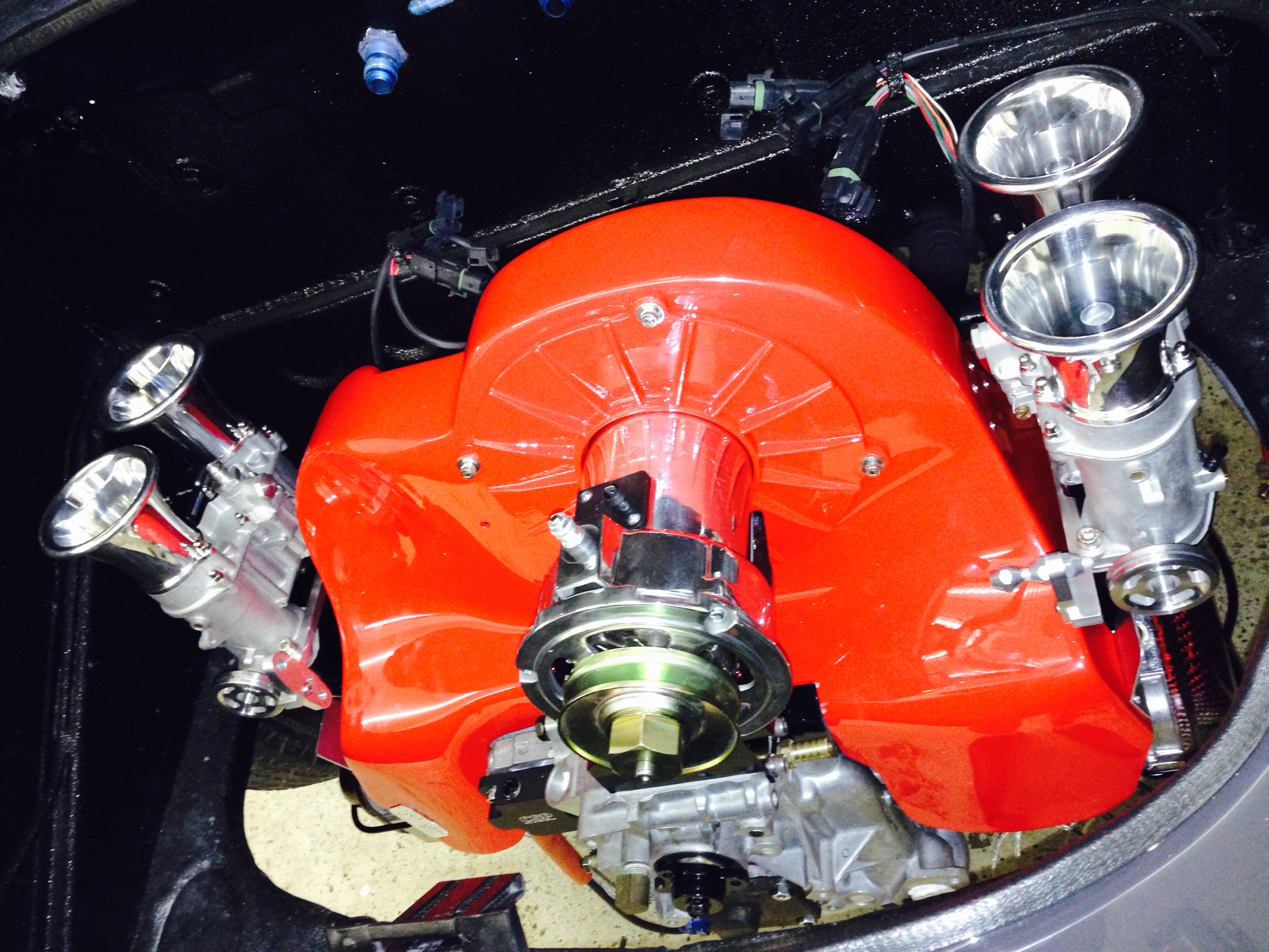

Here's a pic of the engine just after being bolted into the 356 engine bay.. Its all I have handy...

Jake Raby   Here's a pic of the engine just after being bo...   Nov 11 2014, 08:59 AM
