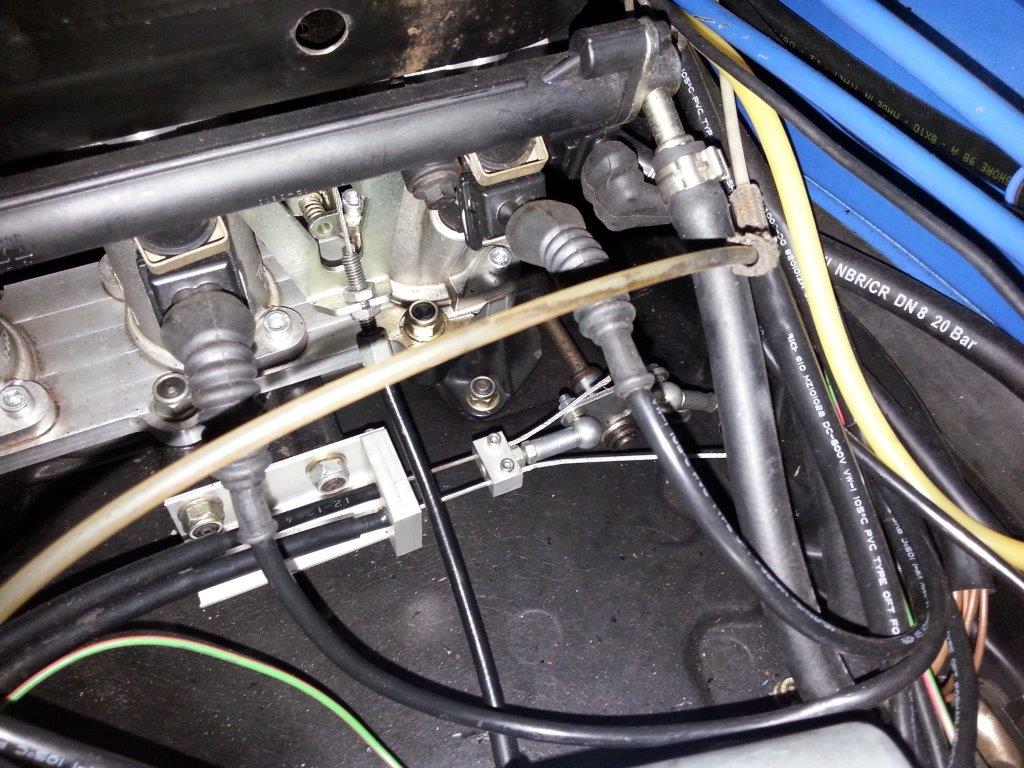

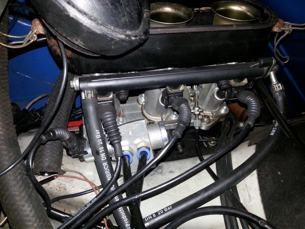

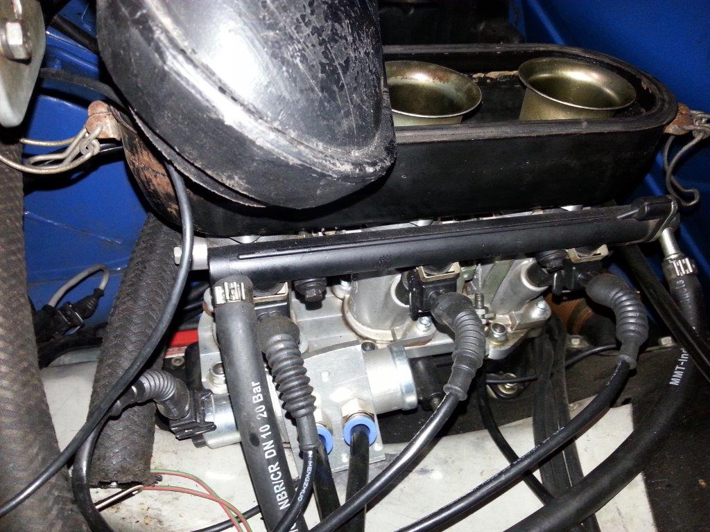

The blue hose is for the map sensor, the idle valve and the vacuum for fuel pressure Regulator.
Since the map is fluctuating heavily i connectet al the Barrels via the blue hose to smooth it out
The second Video is about one year old, balancing of the Throttles was a Little off at the beginning.
I drove it 4500km now on injection and the car never runs better, but i have to do some finetuning to get better mileage
Hera are som actual pics of the engine compartment with the cleaned up wiring.
Michael
