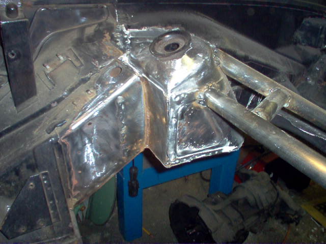

Thanks to Jeroen's thread I decided to cut away the body seam sealer and have a look at how the shock towers are fastened (not fastened?) to the body.Brad & Jeroen I can see how they would tear away after a while with stiff springs and racing stresses. (IMG:style_emoticons/default/smash.gif) Here are a couple of pics..........

I dove into the hellhole last nite with (IMG:style_emoticons/default/sawzall-smiley.gif) in hand,air chisel and grinder and after about an hour and a half here's what I found..........the shock towers not welded to the frame rail!!!! What was the factory thinking (IMG:style_emoticons/default/confused24.gif)

SteveSr   Here ya go Jeroen,I fashioned a piece of sheet met...   Aug 23 2004, 01:40 PM
SteveSr   Whoops.......forgot to post the pictures.............   Aug 23 2004, 01:42 PM
SteveSr   and another......................   Aug 23 2004, 01:43 PM
Jeroen   Steve, I hate to be a critic, but I think you nee...   Aug 23 2004, 05:14 PM

SteveSr   I dove into the hellhole last nite with :sawzall:...   Aug 25 2004, 08:36 AM
SteveSr   one more................   Aug 25 2004, 08:37 AM
Jeroen   <...   Aug 25 2004, 08:40 AM
SteveSr   Yes! very surprised. Now on to the other side ...   Aug 25 2004, 10:34 AM
SteveSr   Welded up one side lastnite :welder: ,now to the o...   Aug 31 2004, 10:52 AM
brant   Perhaps Chris or one of the other expert welders w...   Aug 31 2004, 12:50 PM
SteveSr   :agree: I'm a toolmaker,certainly not an exper...   Aug 31 2004, 01:34 PM
maf914   Steve and Jeroen, Thanks for the photos and expla...   Aug 31 2004, 02:43 PM
