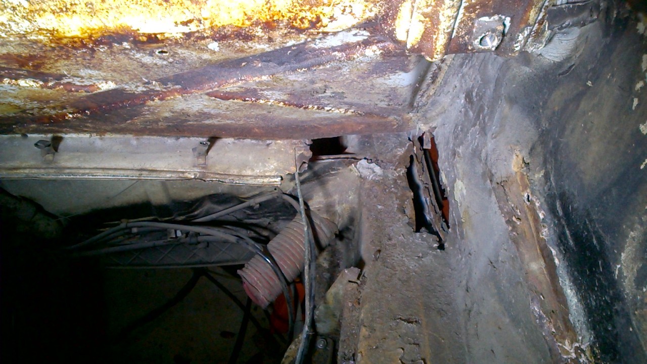

But when I got it home I found that it was actually a 1.8L and it had some ugliness as seen in the hell hole below:
And the floor pans aren't in great shape:
I'm pretty sure the longs need work, so I plan to tear into those in the next couple of weeks.
This is going to be a bigger project than I anticipated....
