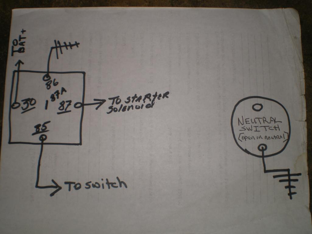

Will one of our electrical wizards help me out with this please. I want to employee the neutral switch on my Suby transmission. Oddly enough the switch is OPEN in neutral and CLOSED in gear. Life would be simpler if vice verse. (IMG:style_emoticons/default/dry.gif) My existing system is as shown in the first pic. BTW, the neutral switch is not going to ground at present or in this first pic.

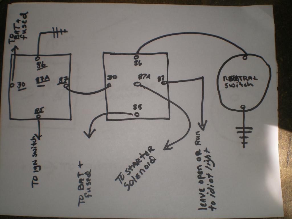

After scratching my watch and winding my ass for the past hour this 2nd pic is my solution. Question: Did I miss something obvious and could I achieve the same result by re-wiring the existing 5 pole relay? And will this work? TIA, kent

76-914   Will one of our electrical wizards help me out wit...   Nov 22 2014, 02:36 PM
Tom   Kent, What are you using the neutral switch for...   Nov 22 2014, 03:54 PM
76-914   Kent, What are you using the neutral switch fo...   Nov 22 2014, 07:39 PM
Spoke   Nice circuit. I redrew it to better follow the fl...   Nov 23 2014, 10:57 AM
76-914   Well guess what. The Suby Computer didn't like...   Nov 23 2014, 08:44 PM
Spoke   Well guess what. The Suby Computer didn't lik...   Nov 24 2014, 09:55 AM
Mike Bellis   I have found on my Audi conversion the ECU likes t...   Nov 24 2014, 08:48 AM
76-914   Spoke, no direct connections between the ECU and r...   Nov 24 2014, 09:02 PM
Tom   Kent, If the gear selector is in neutral, wi...   Nov 25 2014, 03:22 AM
76-914   That is exactly what I plan to do plus check it wi...   Nov 25 2014, 09:11 AM
