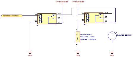

Nice circuit.
I redrew it to better follow the flow.

Spoke   Nice circuit. I redrew it to better follow the fl...   Nov 23 2014, 10:57 AM
76-914   Well guess what. The Suby Computer didn't like...   Nov 23 2014, 08:44 PM
Spoke   Well guess what. The Suby Computer didn't lik...   Nov 24 2014, 09:55 AM
Mike Bellis   I have found on my Audi conversion the ECU likes t...   Nov 24 2014, 08:48 AM
76-914   Spoke, no direct connections between the ECU and r...   Nov 24 2014, 09:02 PM
Tom   Kent, If the gear selector is in neutral, wi...   Nov 25 2014, 03:22 AM
76-914   That is exactly what I plan to do plus check it wi...   Nov 25 2014, 09:11 AM
