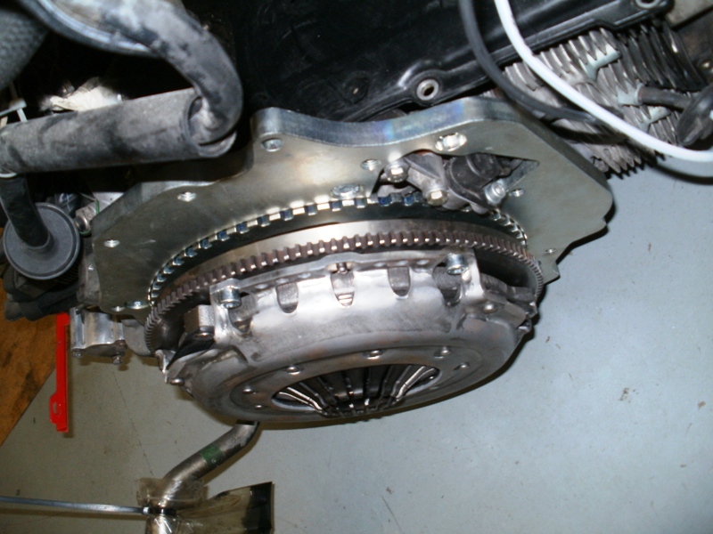

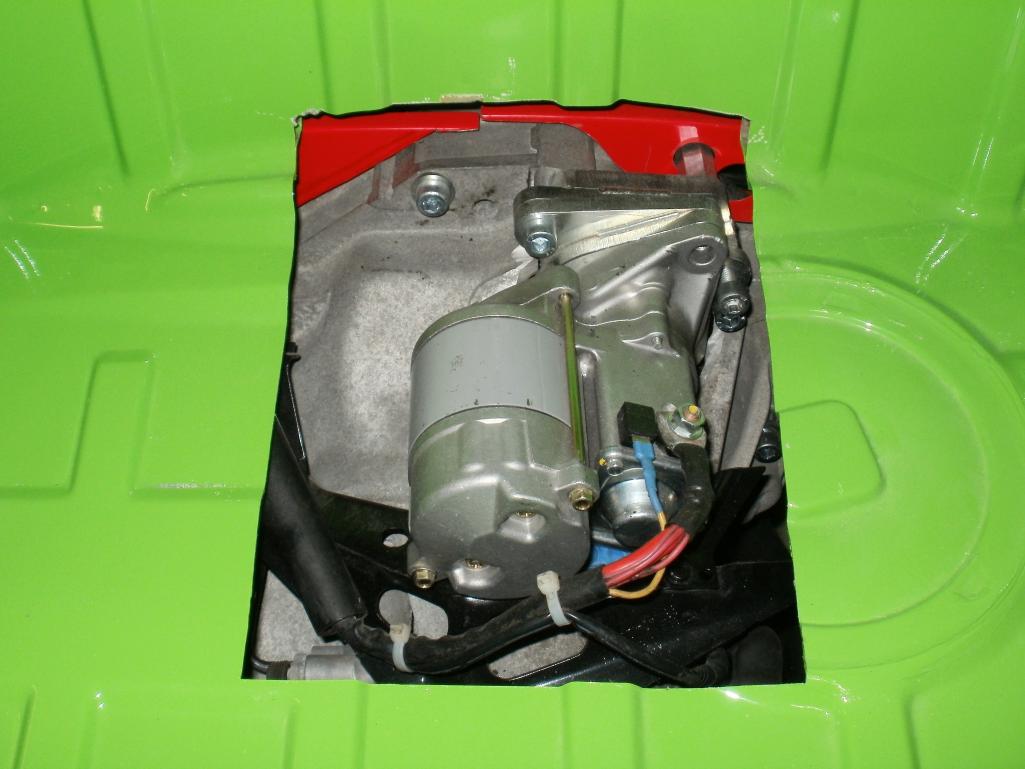

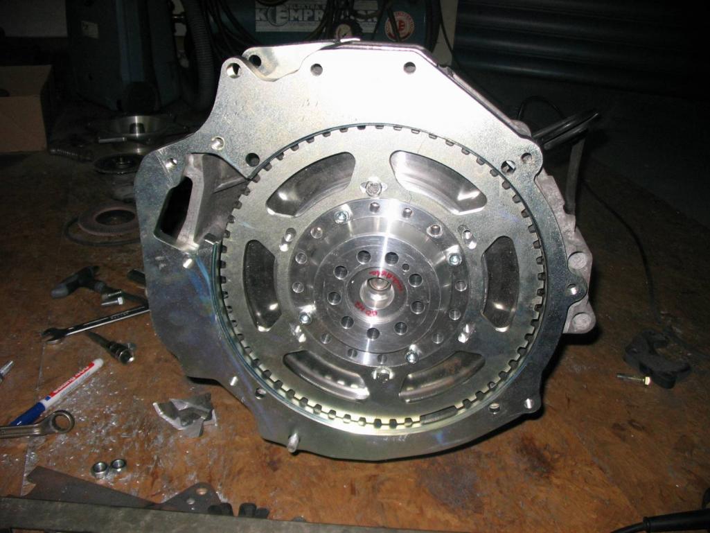

And this seems really close.
Boxster transmission
Starter relocate
Boxster clutch
Just need to setup a flywheel for your application, and drill different holes for your motor....which would be the same for any of the six cylinder motors...
