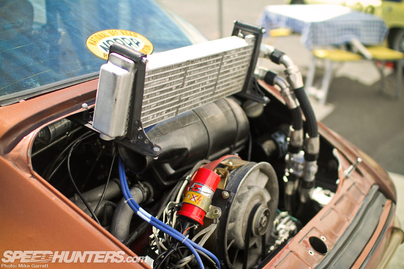

I know this had been tried 7+ years ago, I was wondering if since then has anyone done a watercooled conversion and not put the radiator in the front trunk?
veekry9
post Dec 6 2014, 08:25 AM
OldMember
Group: Retired Members
Posts: 3,068
Joined: 17-June 13
From: TO
Member No.: 16,025
http://www.performanceforums.com/forums/sh...he-porn/page125
Same idea as the 914+Jeep,
Better tho.
Can't think of a reason why a dual rad set under the targa wouldn't work.
