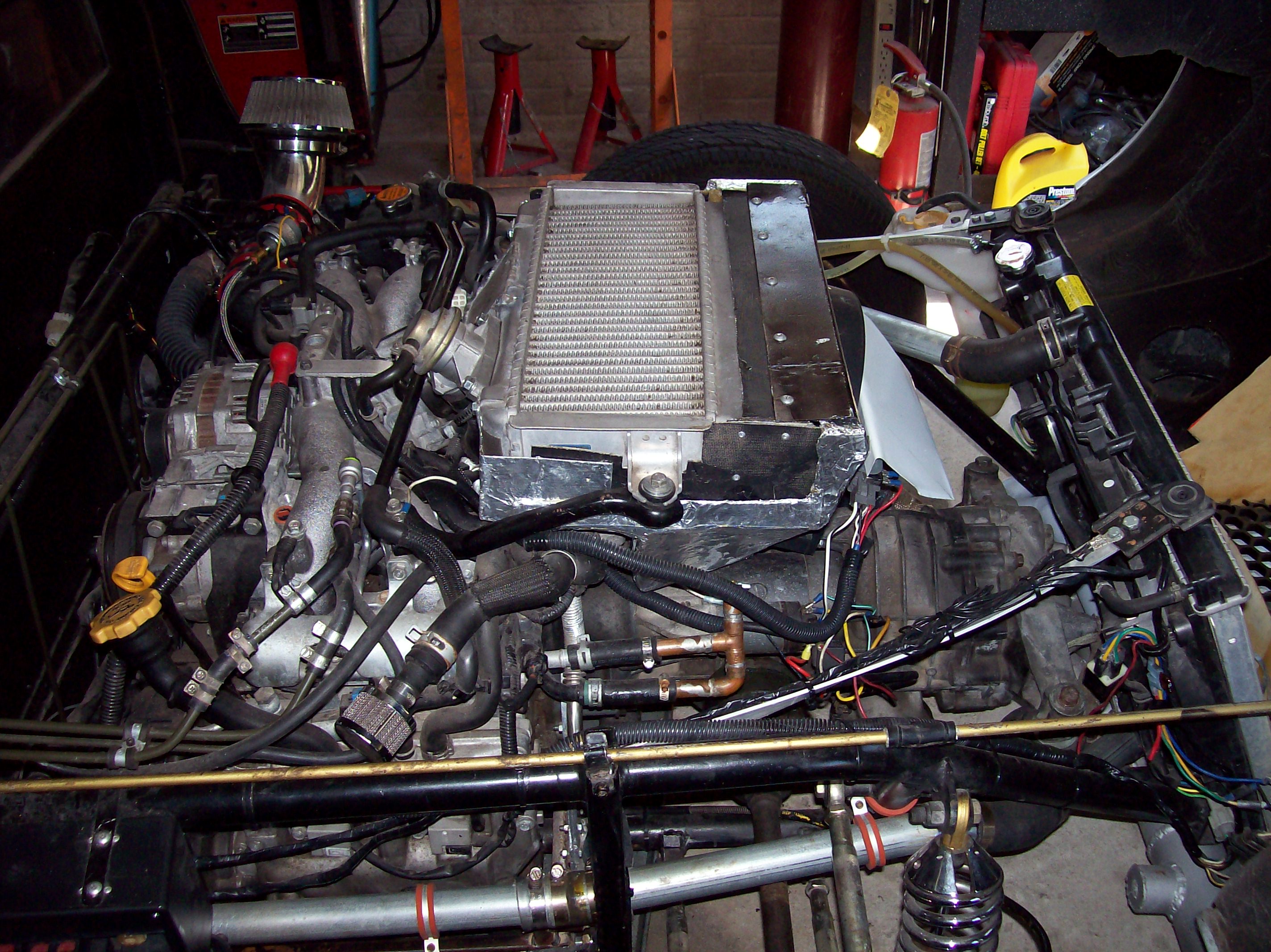

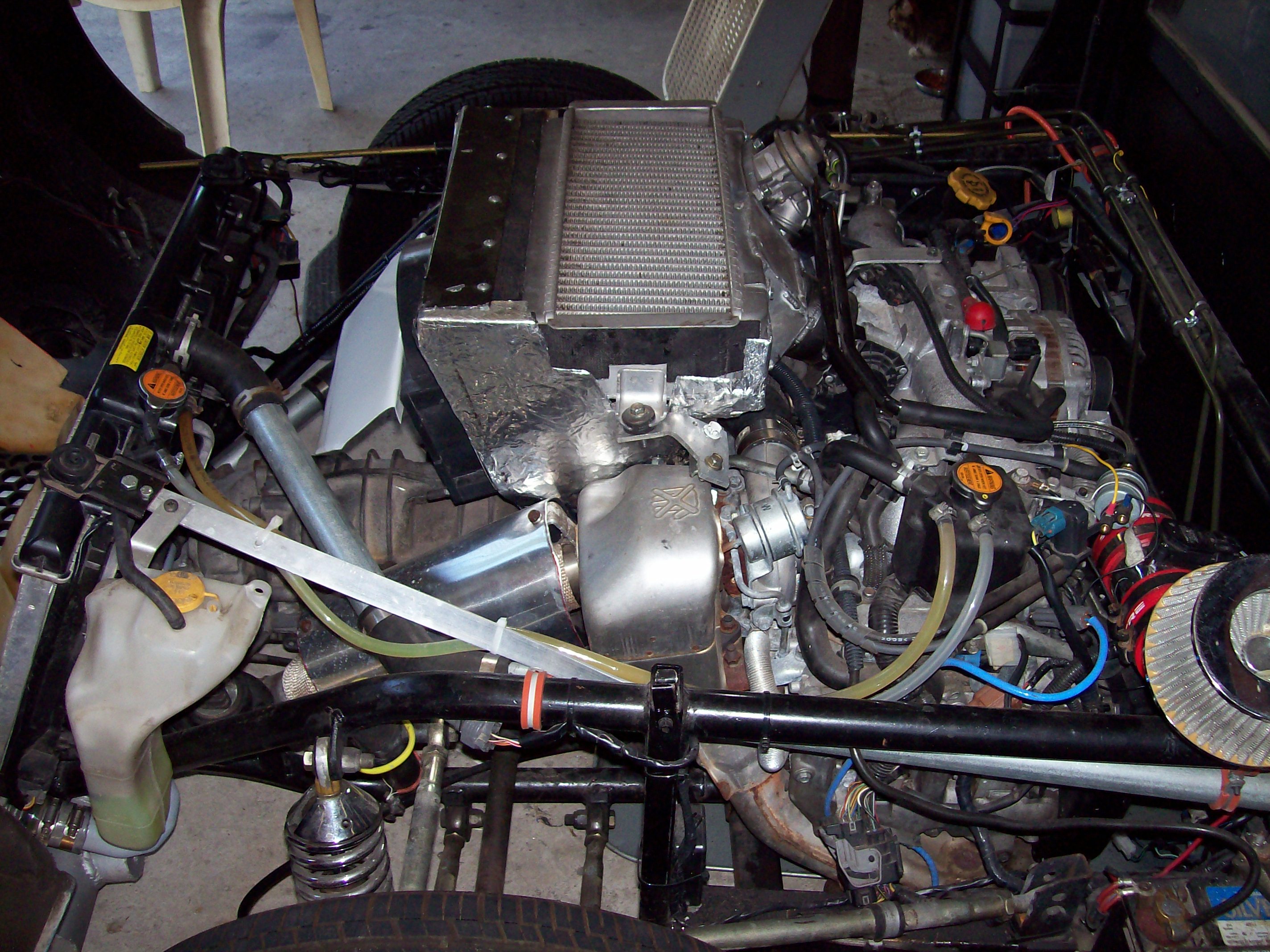

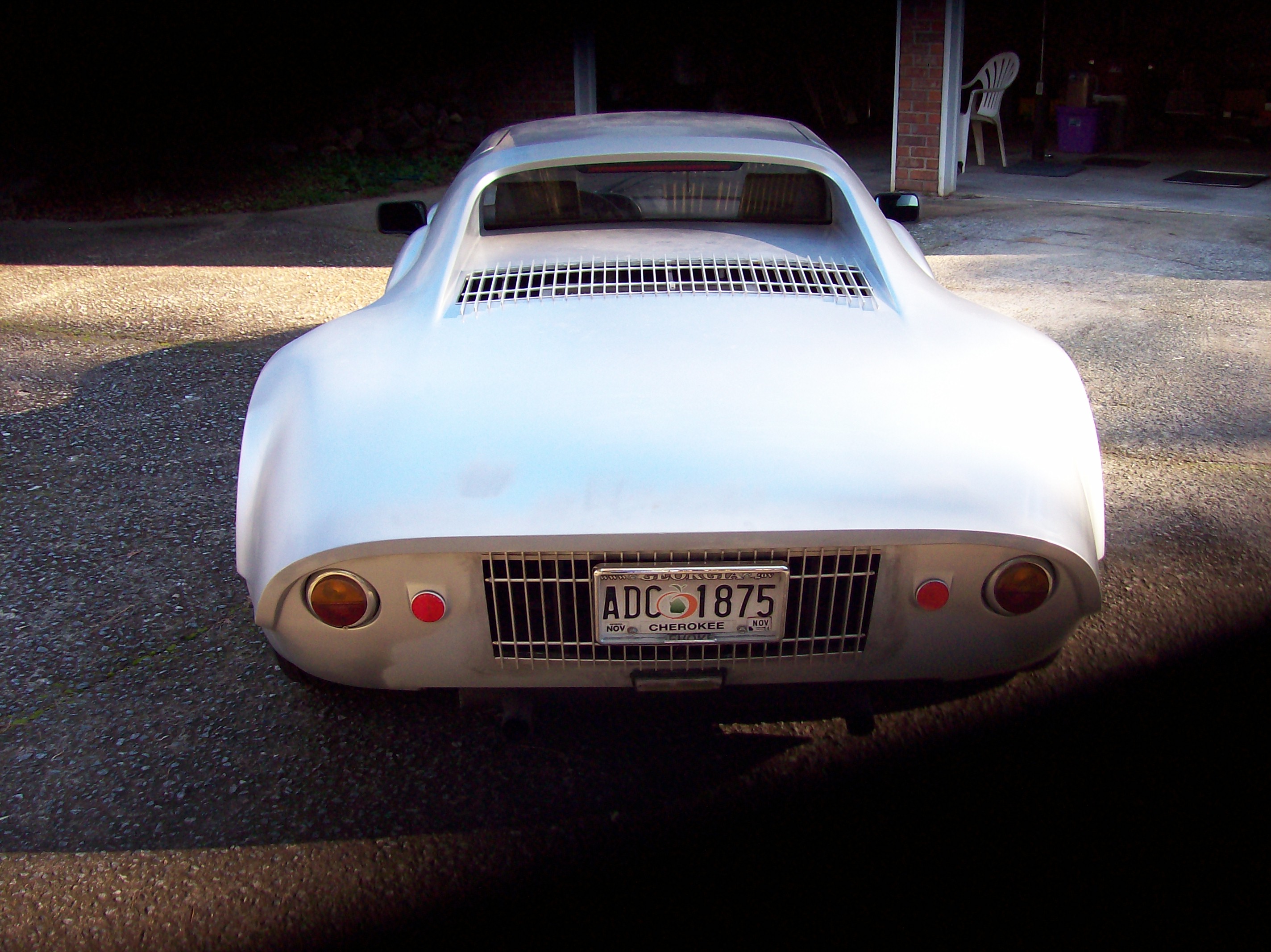

Here is my rear mounted radiator in my 904 kit car (engine is a Subaru WRX)
I'm using a stock Subatu radiator and fans, the engine runs at 195 degrees. I'm
using the air coming off the rear deck to supply cool air into the radiator and
having the air exhaust under the car (low pressure area when moving)
Here are the pictures

QUOTE(904svo @ Dec 7 2014, 07:57 PM) *
And that would fit in a 914 how exactly?
