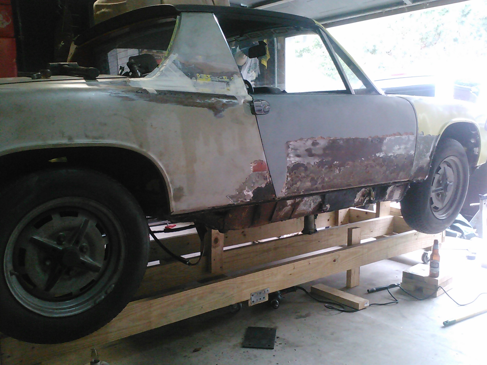

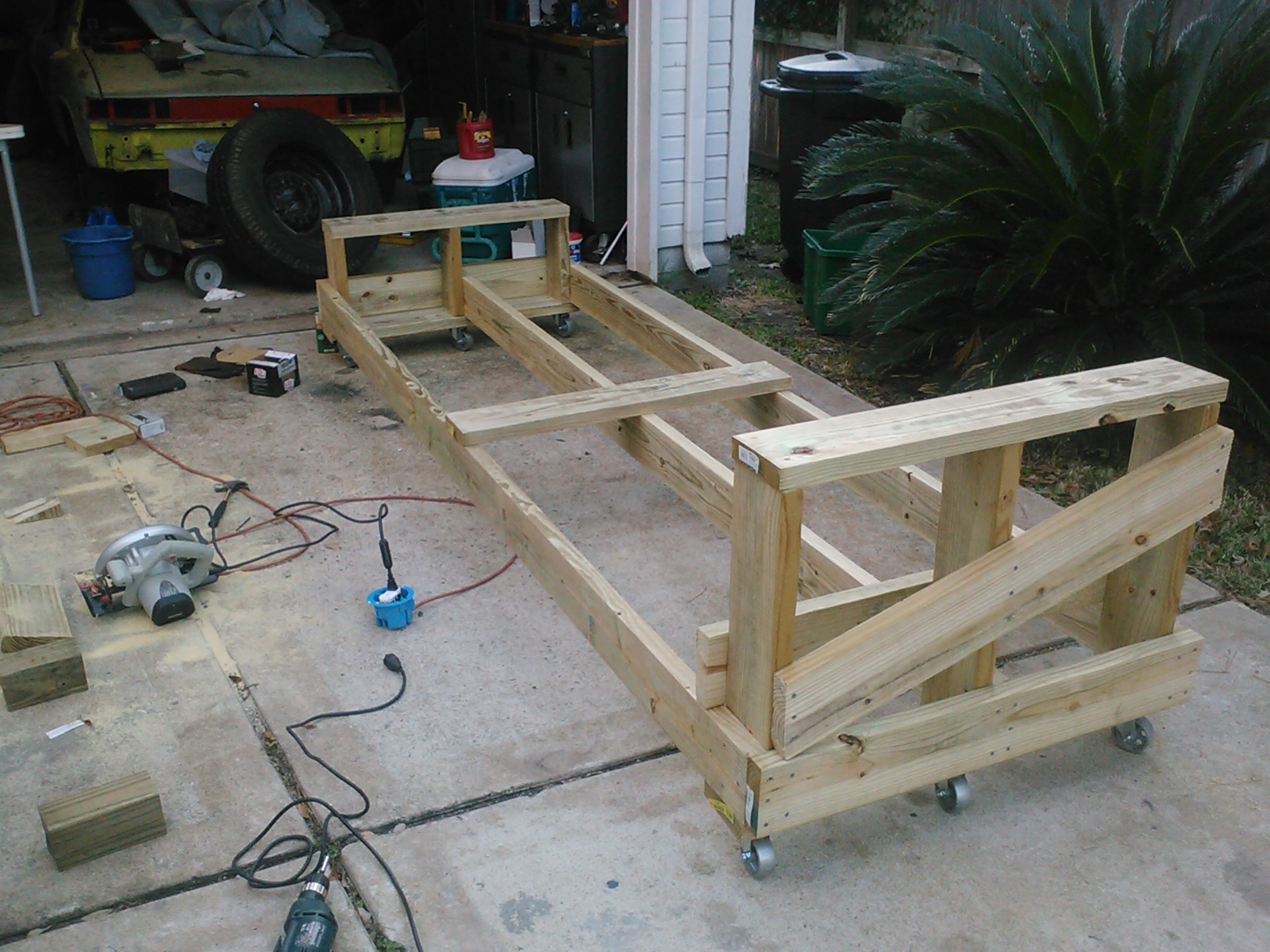

Had I done the test of opening the doors and jumping, my 74 914 would have split in half. So I removed the engine and trans. Built a wood frame with casters and put the 914 on top. This way the car would remain aligned while I cut and rebuild the longitudinals.

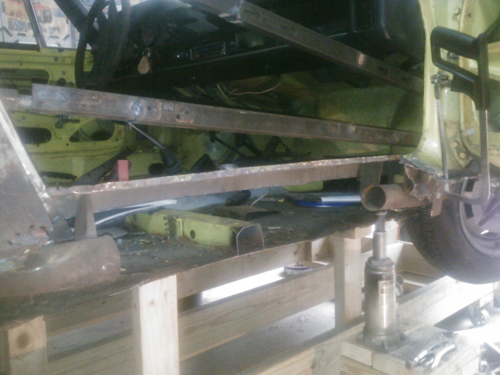

doug_b_928   I built a bench a la Hail and put the car on it. ...   Dec 12 2014, 10:13 AM

Claus Graf   This is what my longs looked like. Had some sheetm...   Dec 19 2014, 06:46 AM
