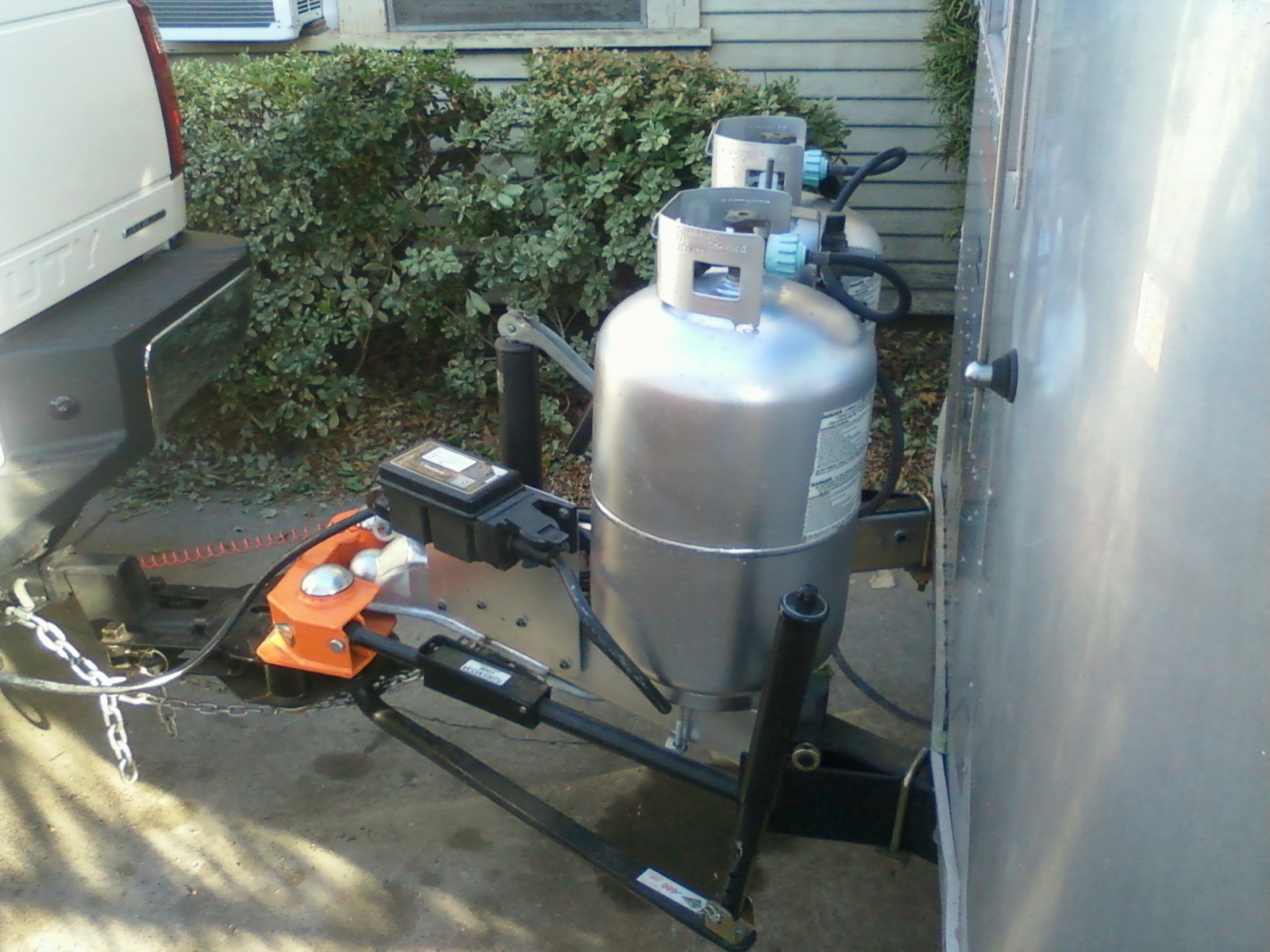

FYI - Here's what I ended up with for the Hensly Cub WD/Anti-sway hitch (smaller than their Arrow & good for up to 6000# trailers at about 60% the cost of an arrow), & Tekonsha RF wireless trailer brake controller (mounts on trailer, wireless hand unit plugs into cigarette lighter/12v outlet in TV cabin).
The Hensley eliminates sway, allows the trailer to turn tighter & all the WD stuff stays on the trailer (except the tow bar/stinger, as with the ball/tow bar on any hitch).
http://hensleymfg.com/
It also resolves the hitch wt. issues on a 928 - & obviates the need for those tow dolly type units, but the receiver would need to have a beefed-up tube strut forward similar to the 928 factory hitch's long forward link to transfer WD to the front axle.
The Tekonsha RF brake controller is essentially a wireless Prodigy P3, that allows me to use any tow vehicle with the trailer. It's mounted high on the plate in order to allow the Hensley's side strut adjuster arm to clear.

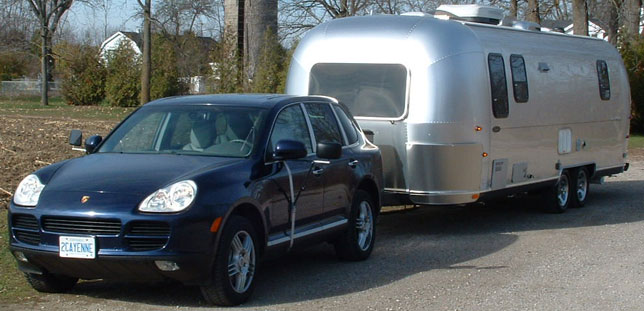

I also got a set of Hensley's McKesh Towing Mirrors as shown on this Cayenne in the pic below, to solve the rear/side view issues with a fat silver twinkie behind the Nissan Pathfinders we were renting to tow, and will use them on the TBD Cayenne S or whatever.
