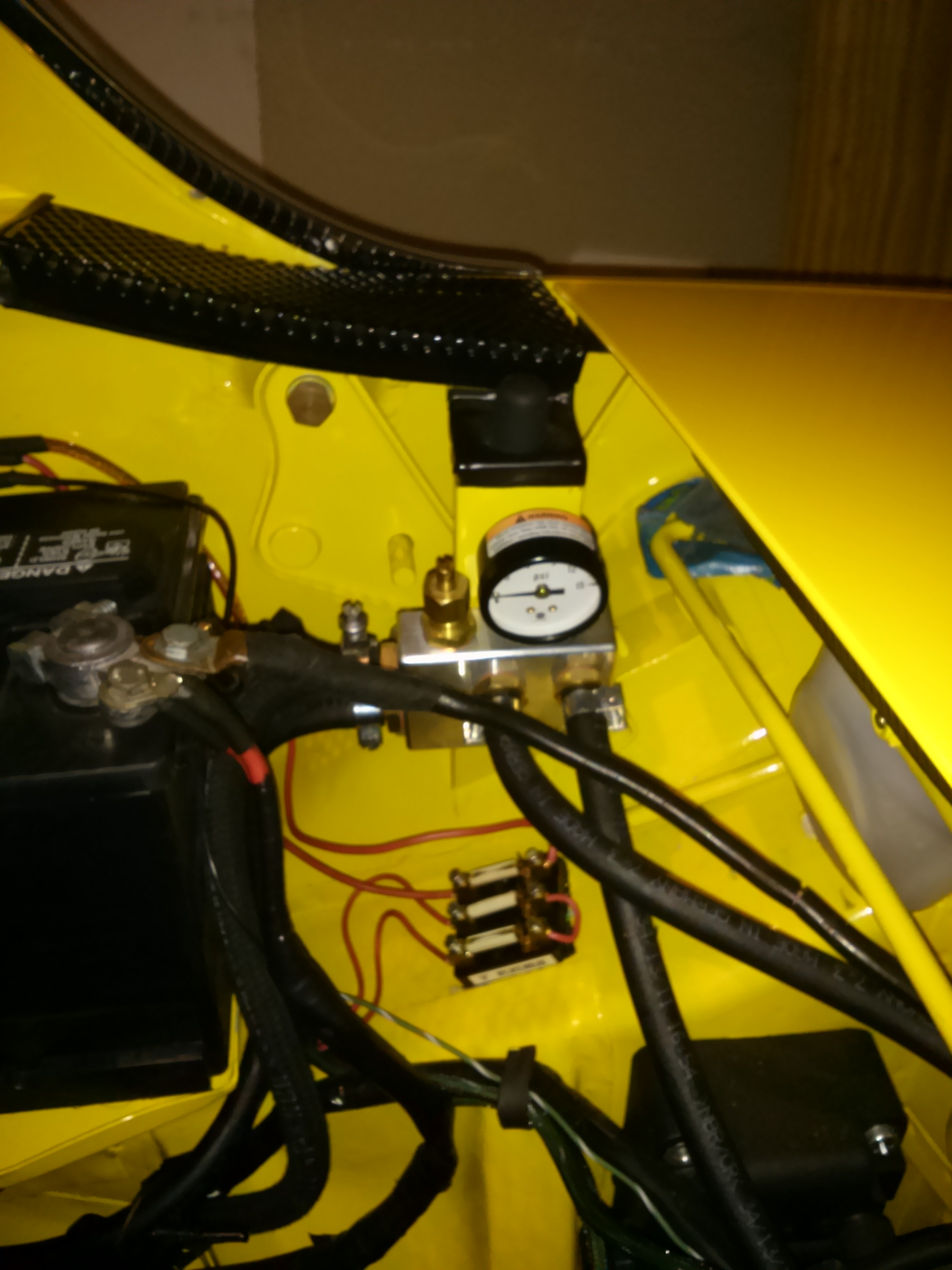

Im looking for suggestions on how to plumb the fuel lines for the PMO carbs. Where should the regulator be mounted?
Socalandy

I dug this picture up from when the engine was installed. Clearly a cell phone picture (IMG:style_emoticons/default/sad.gif)

Socalandy   here's the instructions with in and out layout   Dec 17 2014, 12:29 AM
PanelBilly   That's perfect. I guessed the 2 lines in the f...   Dec 17 2014, 12:34 AM
